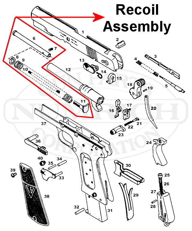

It's been quite a few years since I've owned one of these . I stumbled onto what I think is called a Type 1 ? B prefix serial with stock slot . My question is , "were all P.35 recoil springs captured on the guide rods" ? This one is not . I'm thinking the 2 I owned long ago were captured springs .

Mitch, IMHO all Radoms had the captured recoil spring assy, with a 2nd spring within the guide. TH

The rod looks ok . Maybe a retaining clip or washer missing from the muzzle end ??

Thanks for your help Tom . Part fit fine . Pistol now functions 100%

Thanks Mitch. Since weak or broken recoil springs seem to be a problem with the Radom (I've repaired a lot of them over the years), I had a dozen new assemblies manufactured a few years ago and still have a few left @$100 each postpaid. hellerarms@webtv.net

Be careful with the recoil assembly. I'll tell you a funny story (not funny at the time)...
A couple of years ago, I picked up a VIS35. I did a detail clean, down to taking apart the recoil guide assembly. I was working in an area that was unusually high in clutter (half open boxes, papers, tools). When reassembling the recoil guide, I compressed the guide and lost my grip on it... launching the rear section (part# 11) across the room.
I heard the piece hit the window pane. No problem... must be somewhere near the bottom of the window (you know, gravity). Found the small, captive spring right away... but the much larger rear section is GONE! Searched the boxes under the window. Where could it have slipped? Searched in an ever increasing arc away from the window. How far could it have bounced?
After about 1 hour and much profanity, I finally found it. It hit the window and dropped directly into the cup of the thumb-turn window lock (neatly camouflaged in color I add).
It probably would have hurt if it hit me in the eye.
That's when I got the bright idea to use a vise to neatly and securely compress the assembly while inserting the pin (part# 7). Worked like a charm.

Thanks... I have emailed you and thanks to lawman for posting the exploded view.
