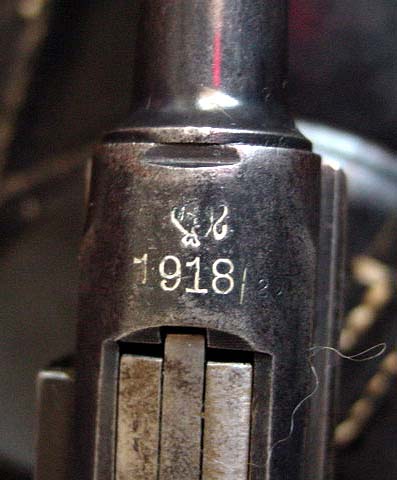

Well, Jan Still covers this marking on pages 105 to 108 of his book "The Pistols of Germany and It's Allies In Two World Wars" Volume 1. (And it may be covered in other books he has authored too.) On page 107 he has a photograph of one of these "Totenkopf" markings, and it is nothing like the one gdk771 is asking about. In the "authentic" example, the date is still on the receiver. (1918 in this case.) And the actual Death Head is small, approximately occupying the same amount of space as the "18" in the date.
Another thing you will notice is that in addition to this Death Head marking being much larger, the details contained in the engraving are far more numerous than the rather sparse lines of the example shown in Still's book.

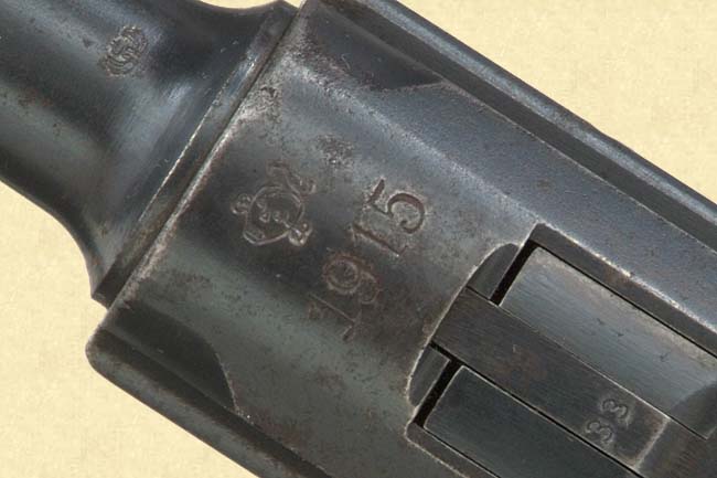

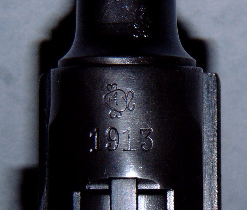

Here are some "real" Totenkopf's:

I recognize that 1913!
