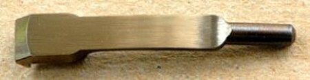

Yes, the extractor with the separate spring was a feature of the "New Model" of 1906 (the new model breechblock with the improved extractor actually made its first appearance with the 03/04 Navy and the so-called 1903 French commercial). The 1900-02 extractor was a one piece spring. I swiped the following photo from Pete's link to Guisan's post.
