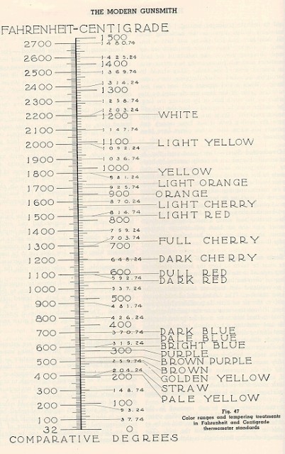

Here's one more item you might need..... I found this in the Member Gallery #4. It was posted by someone whose initials are "Wm."
