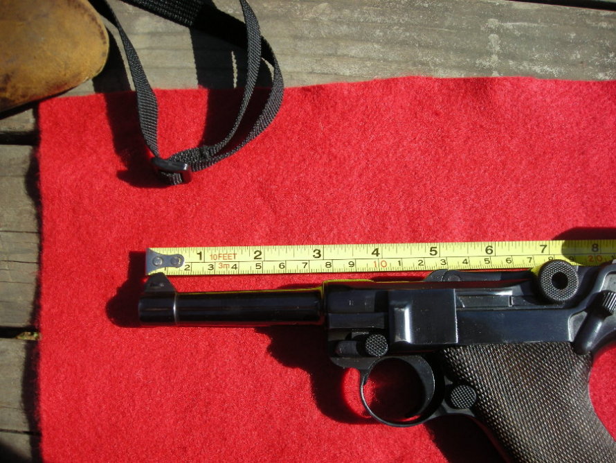

Hello,

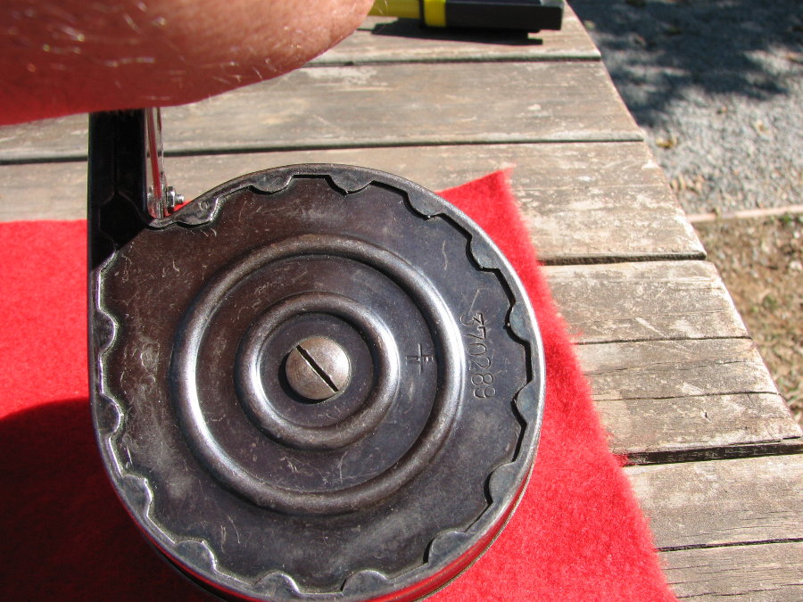

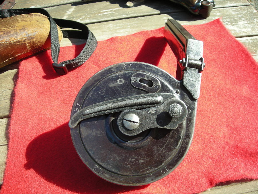

My dad has had this Luger and accessories for about 40 years.He is currently looking for information on the gun and snail drum.He said that it is a 7.65mm and that all of the gun parts have matching numbers.He thinks that the guy that he bought it from said that it has been re blued.What model Luger is it?What might these items be worth?Any info will be appreciated.

tac, I didn't know some alledeged erudite posters made comments about your lack of luger knowledge. I guess they were the idiots, as your knowledge is almost as good as mine, and I'm almost an erudite (I think, I will look that word oup later).
As tac said, your luger being reblued is now a shooter, still worth about $500-$700 in the US of A (prison time in the UK if not registered).
Your holster is a bit beaten, but looks like it was / is a police model, any markings on the rear or other places?
Your trommellmagazine is proabably worth $1000-$1500, again depending on the neighborhood in the US of A. I myself do not own one yet, they are cool.

The Pistol as Ed says is in the $500-600 USD range because whoever reblued it went to sleep while he was buffing it. When he woke up much of the pistol was gone as Tac says. Unfortunate but happened to many pistols after the War. The wood bottom mag is worth $100+
I cannot see the back of your holster so I cannot give but an estimate..
$200-300 USD
Currently snail drums are selling for $1000-1500 USD The most important thing about these it to determine condition. Does it fit into the pistol easily? If not, it's bent.
For a quick sale..$1000- hang onto to it and find the guy willing to fork it over $1400- might take awhile.

Jerry, I just sold an identical trommel mag for $1500 with no quibbling.

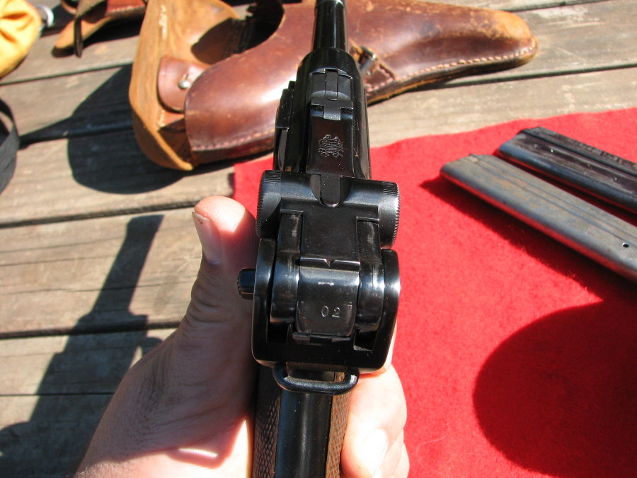

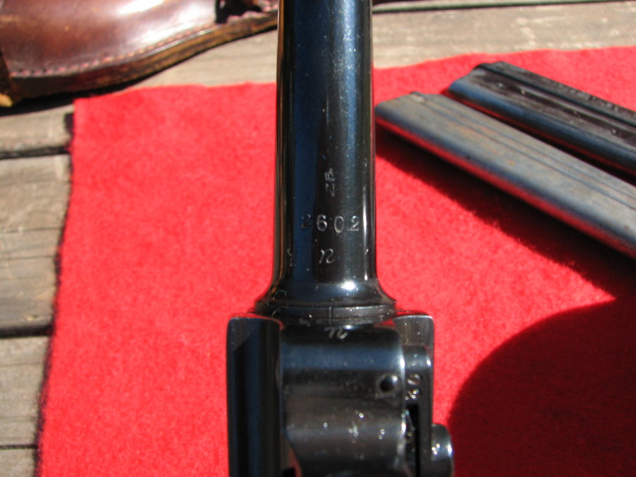

Although it was heavily buffed, I'm not sure why tac feels a chamber date was buffed off. This Luger is C/N proofed, sn 2602n and at least one of the photos shows it was numbered in the commercial manner. I think it likely that this is a commercial Alphabet DWM produced in 1924 and never had a chamber date. My two cents.
