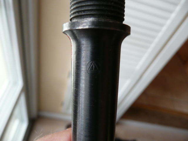

Unread 08-08-2007, 03:41 AM   #26
trigger
Location: Sweden
Posts: 14
Hi Sieger
Could be so. The "original" 7,65 barrel has a T ingraved.
I am told this would be Tikkakoski
Kaj
trigger is offline   Reply With Quote
Unread 08-08-2007, 03:42 AM   #27
trigger
Location: Sweden
Posts: 14
I missed the photo
Unread 08-08-2007, 10:09 AM   #28
Steinar
Steinar's Avatar
Join Date: May 2004
Posts: 1,538
Thanks: 18
Thanked 36 Times in 21 Posts
at first I tought it would be a Lahti barrel.. but instead it must be a Tikkakoski made barrel of somekind? (the image above is upside-down)
Unread 08-08-2007, 11:01 AM   #29
Definately a Finnish made barrel. TH
