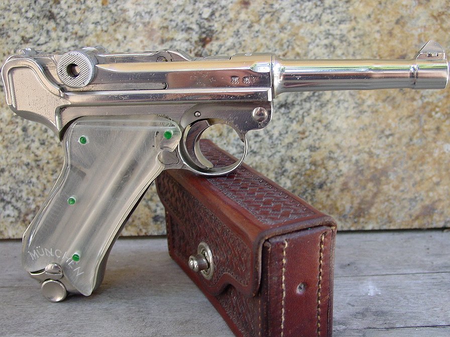

My grandfather, god rest his soul, brought back a P08 from WWII. He claimed he had taken it from th body of a german officer. I am trying to find out as much about it as possible. It is nickle plated and has the Nazi ensignia(eagle and swaztika) printed on the side of it 3 times and 1 more time on the barrel. It has black plastic grips and the letters byf engraved across the top. The plating is original though it has corroded a little because of the holster it was once stored in. Can anyone tell me about this weapon?

That picture is not the actual picture, though it is almost identicle with the exception of the clear plexi glass handles. You can clearly see the insignias on the side.

Travis, welcome to the forum. Actual information is needed to help. Its serial number, suffix and markings. And a picture of it, rather than one like it.
byf's is the code for Mauser, so we can say it was made by them, however, it should also have a date stamp, most likely it is a byf 41 or byf 42?
Lugers were never made originally in nickle, it was very common to have GI's nickle or chrome them immediatly after the war.
ed

Is that a bluge in the barrel . Or just light from camara angle..?

Location: Cleveland,Ohio
Posts: 115
I was just going to say the same thingas I noticed the buldge . Rick B

it might be, but this isn't a picture of his gun...

Well whoever owns the one pictured sure has a problem! That's gotta be a bulge.

Chroming or nickle was done by US GI's, it was never done by the german military. It reduces collector value to shooter value ($450-$600)...

We get asked this a lot. Sometimes gramps doesn't remember he traded a carton of cigs for it while over there. Or that he had it done a few monhts to a 1 year after he got home (it was a lot of years ago). He may very well have gotten it from a GI who picked it up and had it done. GI's were trading and having stuff like this done, including engraving for cheap, a packet of cigs for nice nickleing...
There were NO nickle or chromed lugers carried by soliders or officers in WW1 or WW2....
PS: There is a "belief" by many folks that lugers always came from an officer. Wrong, many enlisted had lugers, p38's etc....
There is a belief that officers officers had nickle plated... Wrong
There is a beliefe that Navy officers had ncikle to prevent rustings... Wrong...

Since this seems to be a dead-end road, with no pictures or info of the gun in question.. perhaps someone can explain the bulge on the barrel? I'm curious to learn how that can happen to a pistol

Simply a matter of pushing enough lead in the barrel. Thus round one gets stuck in the barrel and round two, three and maybe four try to push it even further.
I had a .30 luger barrel with the same visible bulge after a somewhat unsuccesful reloader had tried his luck with it. A round got stuck en two more round were fired before he noticed what happened...

Is it possible it's been deactivated with a barrel insert?
