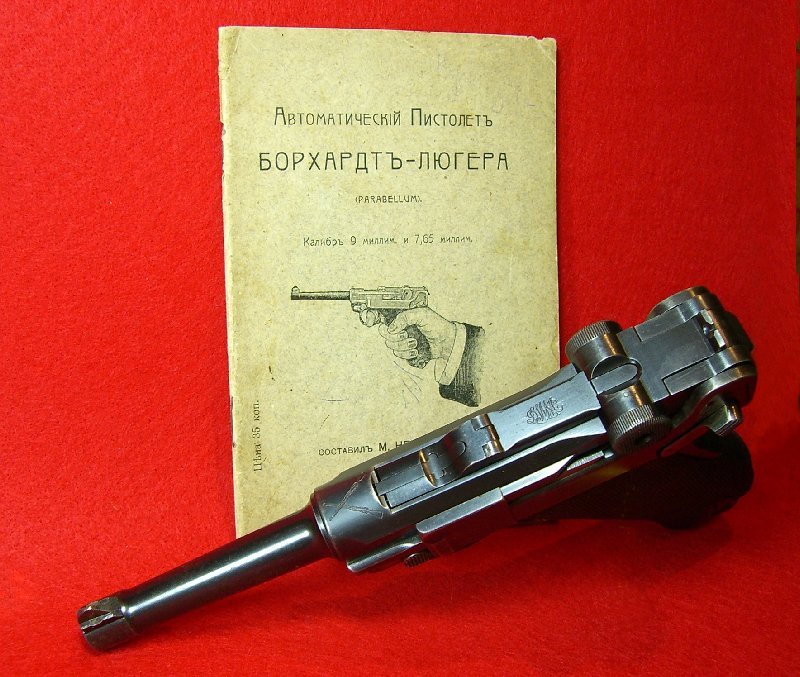

I thought I posted a photo of my Russian along with an ultra-rare Russian manual (I am not aware of any others), but I can't find it on the Forum, so here it is again.

" My God" Ron once again a delite to gaze upon. Thank You

otlich'no Ron... kak vsegda

OK Glen, I got the "as always" part, but the "otlich'no" has me stumped. Remember, my linguistic abilities are really limited!

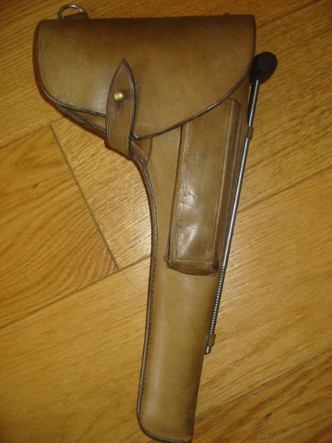

Ron, does anyone know tha range of serial numbers? I felt like the Eagles, DWM had to produce a number of 'russian'holsters, Im told a few survived to this day.
Unread 06-25-2007, 10:05 AM   #7
DWM did not produce the holsters for Eagles or any other Luger. Vanderlinden shows a photo of an "assumed" Imperial Russian holster, but to the best of my knowledge there are no authenticated examples. I certainly would not pay a large amount of money for a "Russian Luger holster" regardless of who is selling it.

Ron, That's a pair it would take a full house to beat! How did you get the Russian Luger to levitate? Nice photo! Jerry Burney

Eric, I have this one in my Museum of Horrors...

Everyone knows that levitation is just simple magic. Actually, I tried a new trick and it worked pretty well. I propped up the Luger with a toothpick and then retouched the photo to remove the image of the toothpick. By working the angles and placement of the toothpick, I didn't have to do too much editing.

That manual on eBay was back in November and I won it. It didn't make it to $1K, thank goodness, but I probably would have gone that high. I do not know of any other Russian manuals, so I feel very lucky to have landed this one.

Wow, Ron! I am absolutely impressed!! Your collection is amazing...
Thanks for sharing that with us. Not only have I learned more about Lugers but gained some very useful knowledge of how to photograph handguns...

Ron Absolutely amazing. What a pair. Thanks for sharing. Bill

And you said that I find some "goodies". That's a "goodie" I'll take any day. A beautiful pistol... The manual ain't bad neither...

That photo of your Russian Luger and book is simply amazing.
