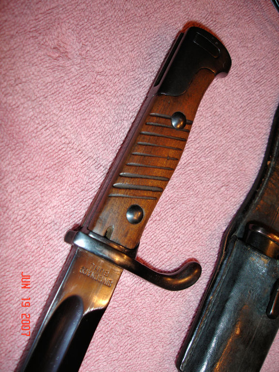

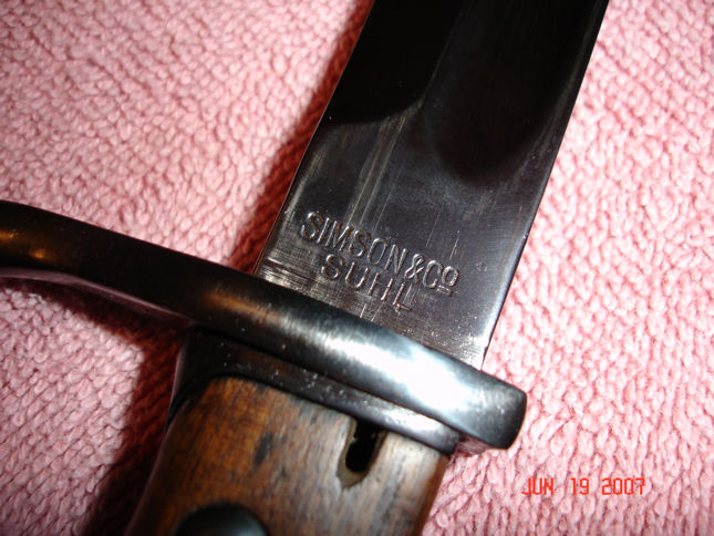

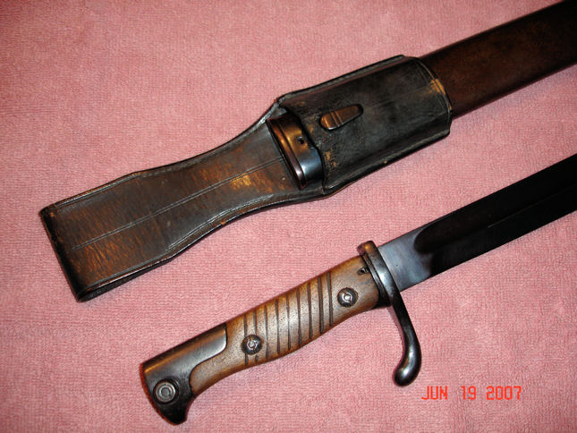

I've seen the stamps on my dad's bayonet several times in the past years since I was a kid, but they didn't have any meaning to me until I joined this forum.
I was visiting my dad last father's day and we once again took out all of the things he brought back from Germany in 1945. We've only done this maybe 5 or 6 times over the years that I can remember. Well, when I saw the maker of the bayonet stamped on the blade, my jaw dropped. This time it meant something.
Mike C.
Here's the pics.

It is funny how something doesn't strike a bell until later when you find out some more information. I don't know a lot about simson making WW1 bayonets, although they, along with about 20 other manufacturers made several styles of bayonets during ww1 and into the weimar era. 100,000 of thousands were made. In addition, Simson had the sole contract to refurbish and make arms for the Reichswehr through the weimar period.
This appears to be a model 98/05 bayo, made in WW1 and used throught the weimar and WW2 eras.

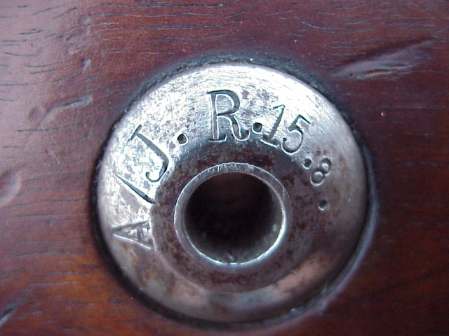

Do you or anyone else know if Erfurt made bayonets and Lugers? This won't be in your book because Erfurt stopped making Lugers, and I would assume anything else around 1917 or before. Unless it shows it as being refurbished by Simson or one of the other 20 manufacturers you stated earlier.
The reason I ask is that the bayonet has Imperial proofs on every seperate part, even on the grip screws (actually nuts and bolts) just like Erfurt Lugers. And then refurbished by Simson. Or maybe Simson manufactured it and used the same technique and the same or simular proofs as Erfurt.

Erfurt made bayonets up to 1915 (significant numbers..) they made the Sg98 until 1907 or so; the Sg98/05 and 84/98 II to 1915.
Naturally Simson Suhl being so close to Erfurt (both in Th�¼ringen) meant they had a relationship, - and Simson Suhl did far more than make bayonets even before the Great War, - or post war make & rework the P08 etc.. they were a significant mfg considering their size and even before Weimar era they worked conversion bayonets, made spares for several projects (MG production as well as rifle production- to Mauser Oberndorf, Saxons etc..) they also made fuzes for artillery, they even made swords..
Simson Suhl bayonets are generally not rare or scarce, though some of the early Sg98's certainly can be.. they had a naval contract early on and some are marked to the Seebataillon units (only Erfurt and Simson Suhl so far I have observed..) generally Simson Suhl had a relationship with the Saxons, and they were a well regarded mfg during the Great War.
Postwar is another story, - still a well run and quality producer but they picked up more than their fair share of enemies along the way (not that they had a bunch of friends before the Great War- DWM made some trouble for them early in the Great War- not that DWM got along with any competitors?)
The nazi's put the final touches on Simson Suhl, with some help from other "unfriendlies" like Fritz Walther.. ahh a long story, that I am sure Ed covers in great detail coming up in a couple months!
Look forward to your book on Simson Suhl, - not a lot on Simson out there, at least in English.. Simson Suhl has been an interest of mine for some time and my German is terrible! (surprising number of works exist in German, though naturally they focus primarily on the 1930-1935 period where it gets a bit nasty for the Simson brothers..)

If the mfg is Simson then they made the bayonet; - Simson converted older versions as well, the Sg69 were converted to Sg69/98 by Simson (over 20,000)- repairs of rifles and bayonets were often done in the rear, interestingly largely in Artillery depots, this is where battlefield rifles etc.. were collected, sorted to needs and if simple repaired/cleaned stored/ re-issued, if more complicated work was needed it would send them to the arsenals.
Whether P08 is the same I suspect so, though to Erfurt of DWM one would think if more than a simple process is required?
Erfurt like all the state arsenals worked on a different level, a different perspective, though all were concerned with working together for the same goal, namely many of the arsenals (and Simson a special case certainly included with its responsibilities to the Saxon/Dresden depot) were tasked with "parts" supply for others to assemble rifles etc.. The idea being the more complicated parts were bottlenecks to production and the arsenals would make such parts enmass to facilitate other facilities production- Erfurt for example did trigger guards enmass and this shows on rifle sporting Erfurt acceptance c/frakturs.
Simson too had contracts for spares that were largely supplied to Dresden, - most every concern was involved to their ability in some sort for this process, Simson Suhl simply was "better" at it apparently (they certainly met expectations where many didn't)
All bayonets will have acceptance, a final with cypher of course but especially on early pre-war every imaginable part can and would be acceptanced- screws you name it.. Simson made bayonets very early- 1910 on for the Sg90/05 such as yours (very scarce pre-war- I have only seen a handful, and I am a Simson fanatic..) the Sg98 very early as well, some not donâ??t dated in naval practice with the cypher, my SB Sg98 made by Simson isn't.
Generally most Simson products were for the Saxons and have their "style" of acceptance/proof, which is somewhat different style than Prussian.
Yes Simson "acceptance" and proofs are different than Erfurts, Simson's changed at times, and product. Apparently Dresden set up an inspection office for Simson for their contracts, though Erfurt helped as well, especially early on with DWM's arrogant attitude towards a commercial competitor, which was eventually overcome.
Postwar, Ed is right, they did have a lot of variation to acceptance, and following it sometimes is interesting- I think dates are an issue with some of the acceptance (e/67 & e/81 comes to mind as it seems to have a "time" issue as it relates to the Gew98M reworks Simson did post war.. the e/6 is so typical some I think only associate e/6 with Simson but as Ed alluded to there were a good number, most I only have limited observations on)

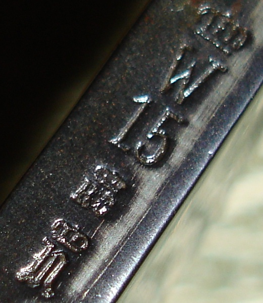

I'll take another picture of the top edge of the blade with a group of proofs or acceptance marks tomorrow night.
Please explain the cypher to a newbie on the subject.

photo posted for Mike. There were literally tens of thousands of bayonets made in WW1 (before and after), many modified also. If you go to ebay and put in Simson Suhl yoou will see 3-6 for sale at any one time.

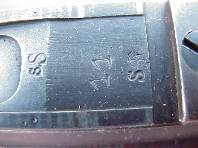

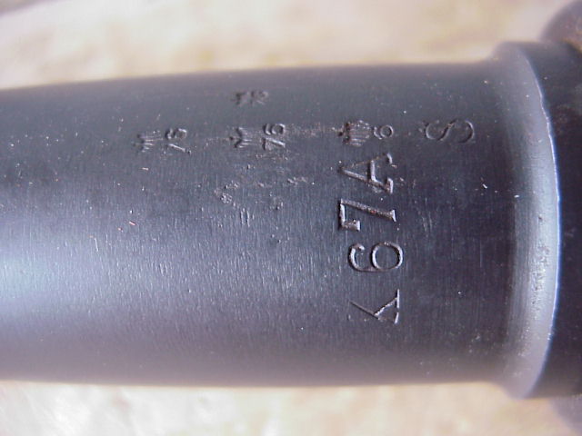

The "S" is often found with Simson acceptance, - obviously attributed to Simson Suhl, this example rifle has e/6 & e/76 accepted barrel with the "S" as is typical. (also a rearband upgrade acceptance e/6)
The unit is the 15th InfReg Training Company; I will upload a pic of the barrel, its a cool rifle as its the only Gew98M done by Simson, originally made by Simson...
In the AutoMag, next to last issue, and on the website Dwight went over some of his thought to this "S" and his seeking answers as it relates to the circle aspects, - I can't say I have seen any such "circled "S" logo" or what ever used beyond the P08? I will say the "S" in several forms is very common and near universal in one form or another as it relates to Simson products during the postwar era.
I had some thoughts when I first read the article but off hand I forgot my line of thought, though it could very well be unrelated to Dwightâ??s exact query.
Was a good article though.

Training Company of the 15th InfReg

Interesting. Yes, Dwight (and me and Don) have been interested in the Circle S, I do not believe it is for Simson.
The "S" that you see on a few luger magazines and on the toggles is more unusual than usual.
How often have you seen it on rifles and the like? To any collectors, if it is an "S", it must be Simson, but it could also be Suhl, Schmeisser, Saur, etc., although likely and thought of by collectors is for Simson, as it is seen on Simson ad's and triangle S.
In my fact finding, I try to use the geneology standard, prove it to me from at least two unrelated facts to prove anything It is not always easy to do, but convinces me a lot more
