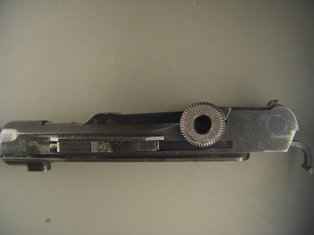

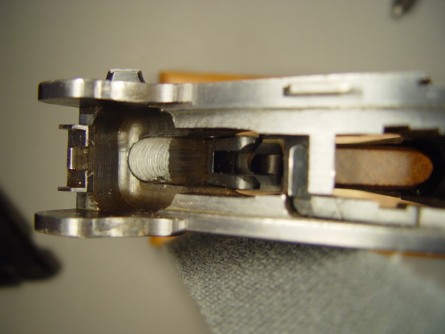

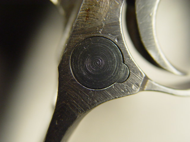

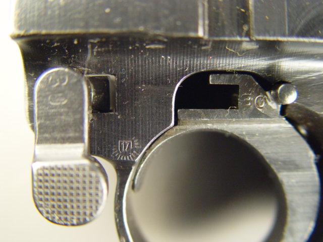

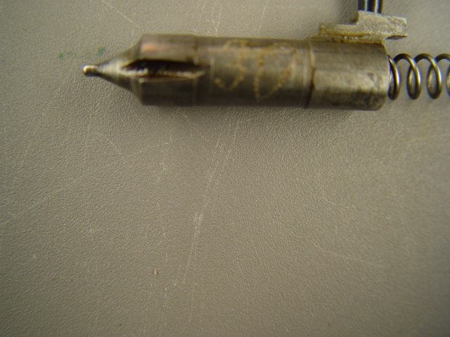

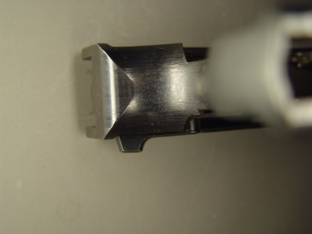

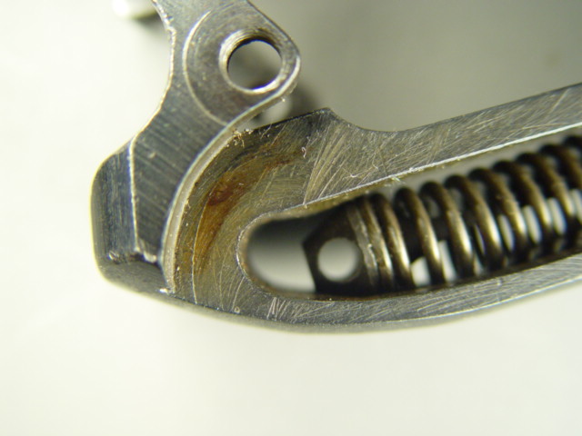

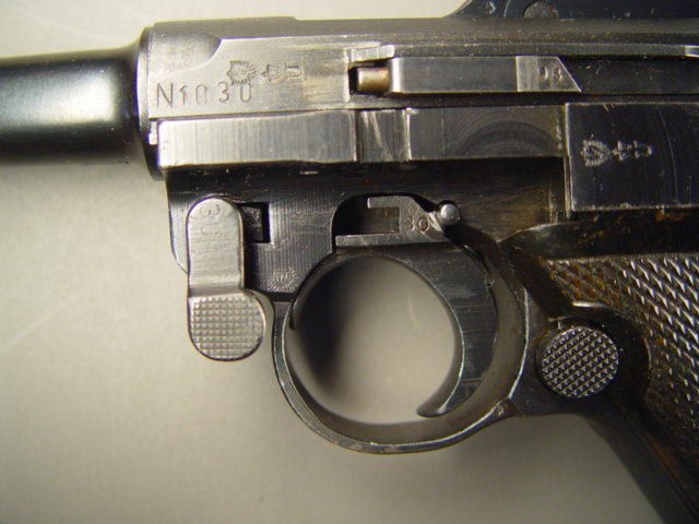

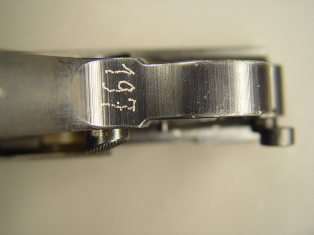

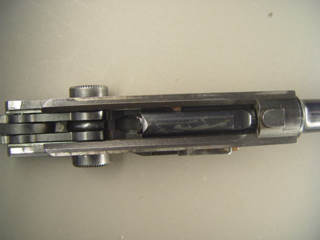

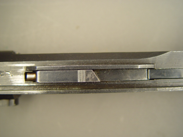

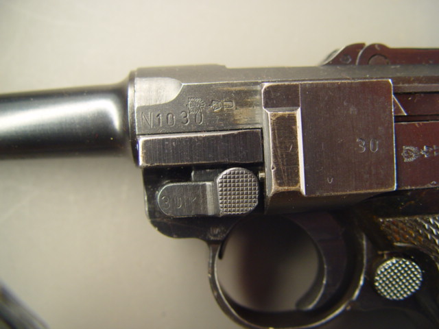

Hi all;

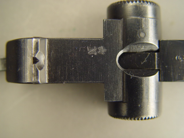

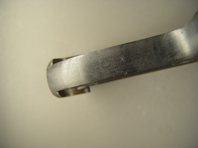

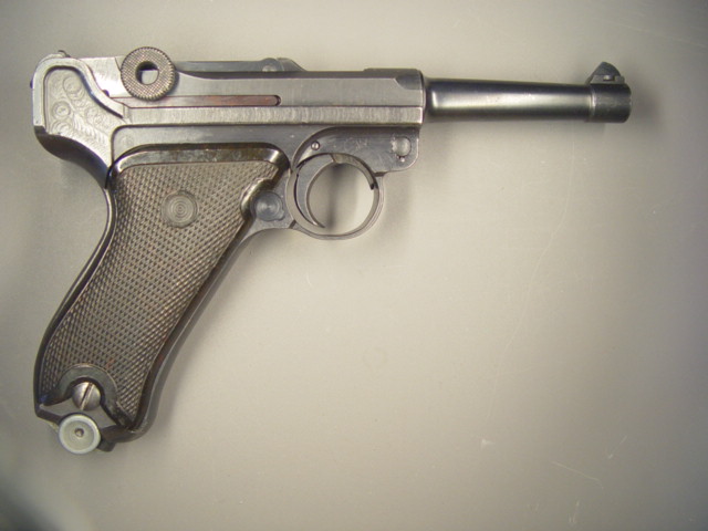

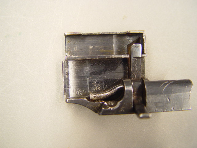

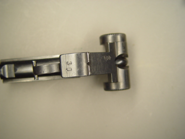

I have the story Dwight Gruber eluded to in his note about the Portland Gun show. I found this luger on the table of a dealer who specializes in machine guns and high tech modern military guns. I have no idea why he had a luger other than he probably bought it in a group of Russian capture pieces or took it in a trade for some of his other inventory. At any rate I looked this over and said good shooter at not a bad price for today's market and left it in his care.
Later that day I ran into Dwight Gruber (nice thing about living near Portland), we talked a little about the lugers in the show and Dwight showed me the list he made of what was there. I didn't see the shooter so I asked him if he'd seen it, he said no so we worked our way to the last table on the southwest side of the building (almost out the door at the back of the room). Dwight asked to see the luger and started to inspect it as I was telling him it had some E German proofs on it. Dwight looked at it for a few moments and turned to me and said "You need to buy this gun....Right Now!". That's when it dawned on me that this was one of the 100 or so E German manufactured guns built in the early 50's. I have know idea what the value of this gun is but I am sure it is more than the shooter price I paid for it. Being one of the rarest production runs of luger ever made I view it as a once in a lifetime find.
I have been trying to find out about these guns but not much has been written about them. None of the better known reference books even acknowledges that they exist. The only information I have comes from this Forum, Jan Stills Forum, and what is written in Buxton's P-38 volume III.

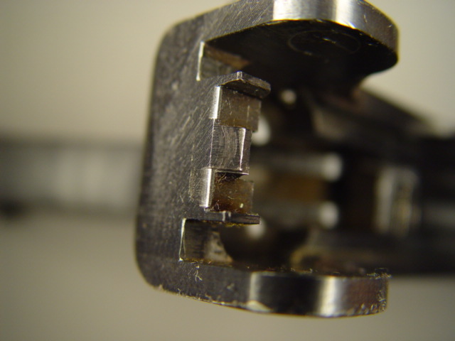

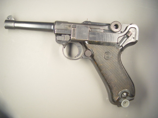

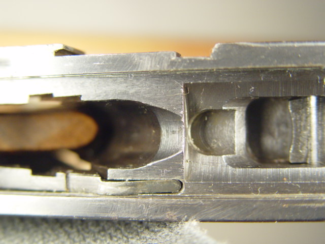

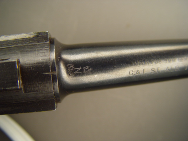

Here is what I can tell you about it along with a number of pictures. If you want to see something that I didn't take a picture of let me know and I'll try to get a shot of it and post it.

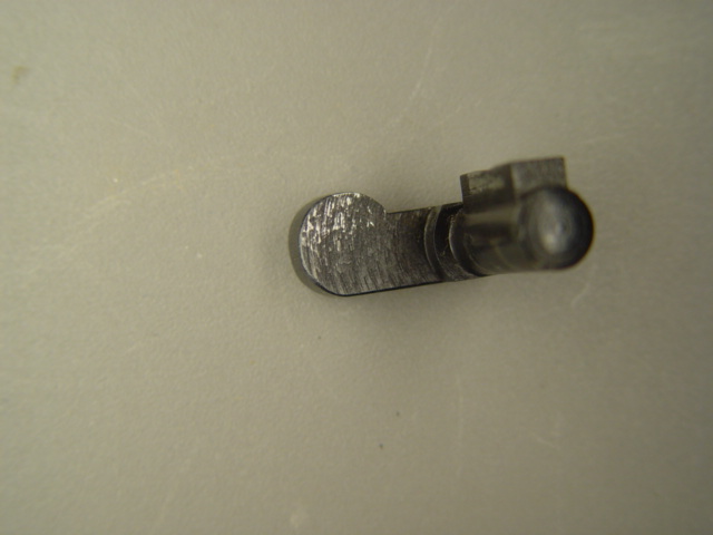

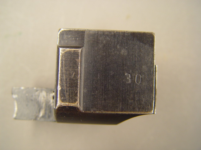

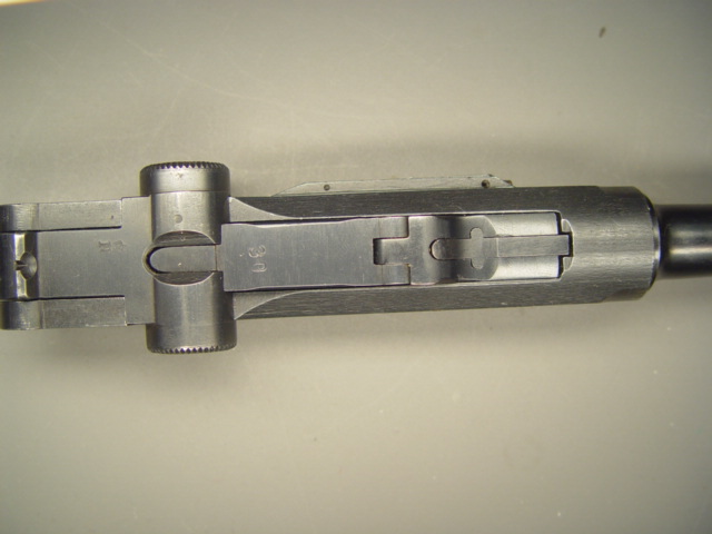

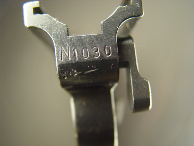

The gun has what I believe to be an E German manufactured frame and receiver, both serial numbered N1030. The barrel is E German, date coded 653 for June of 1953. The breech block, sear bar, safety plate, and hold open appear to be reworked WWII pieces, all of the rest of the small parts look to be of E German manufacture. I don't know if all of the parts were E German at one time and the gun was then refurbished before being sold as excess or if the WWII parts were part of the original build. At this point it's difficult to tell. The barrel has a stepped chamber (couldn't get a picture of that) and is in excellent condition. The frame has no lanyard loop or stock lug, is not re-enforced and is very roughly finished on the outside. The back of the receiver does not have the Mauser Hump. The sear bar has a hole for the pin of a sear safety and the side plate is milled for the same. It does not appear that the gun ever had a sear safety installed.
If anyone has more information on this series of E German guns I would appreciate if they would post it here or send me a message.
Thanks,
Bob M.

Bob,
Glad you finally told the story, also glad to see the gun again in the pictures. Don't forget the 2/1001 mag.
It was a very great pleasure to have a hand in the discovery of this Luger.

Hi:
Fascinating find!!
Truly a find of a lifetime!!!
Who built this Luger? Krieghoff?
Where did they get the machinery to build it?
Sieger

I own the one George mentioned. They were, in fact, built on former Krieghoff tooling. There is an article about them in, I believe, DWJ, but I have not been successful in getting a copy. The guns are a testament to the fundamental differences between a socialist and a capitalist system....

Bob & Dwight, Great find. I once owned N1031 but sold it to another Forum member. Pistol as you describe, also note the lack of checkering on the top of the toggle knobs. Only about 150 of these made at the Ernst Thaulmann werks in Suhl in 1953, as they were considering going back into production, but due to Russian insistance, decided to produce the Makarov instead. TH

Thanks for the info on the DDR, what information is available on these is very scarce and hard to find. What I know is mostly from here and Jan's forum. I had read in Buxton's book that the program was discontinued due to 'a commitment by the Russian's to provide more modern Russian weapons', I think Tom's interpretation might be closer to the truth.
Dwight, I have pictures of the magazine and will try to post them with this reply. My computer started to freeze up last night while I was uploading the pictures so I stopped and posted what I had rather than risk loosing what I had already uploaded.
Ron, you should come up and "hang out" with Dwight and myself, maybe we can get Russ Witham to show up and we can have a mini forum gathering. There is a show April 20-22, let me know if you plan to come up.
Tom A; any chance you could post some pictures of your DDR? I would love to compare them. On yours, what parts are new manufacture and which ones are leftover WWII parts. I am not sure if mine was all DDR at one point and refurbished or if it started with some leftover parts. There is not enough information on these to truly know at this point. Buxton's notes on the P-38 indicated that some leftover parts were interspersed with the new frames barrels etc.
Thanks,
Bob M.
PS; my computer is still hanging up when I try to upload photos, I am sure it's on my side so I'll try to clean things up and upload the magazine latter.

MarkC your gun is outstanding with the two matching magazines and the holster. Mine came with a magazine thats correct for the gun (2/1001) but it doesn't have any markings on it. I don't know if someone removed the marks that were there or if it was never marked. I lean toward the latter but am open to inputs if I can get the pictures up on the board. I'll try to post the pics tonight, I think I have the computer problem solved.
Tom A, yours is not import marked, that's outstanding. The one I have is as it probably came in with a batch of Eastern block pistols that were sold to the US. With this rare a gun I doubt it matters but it would be nice if it wasn't there. Do you know how your gun made it way to the US? I expect it must have come back with a GI or German tourist in the late 50's or early 60's.
I am still trying to find out if these guns were 100% E German parts or if they used a mixture of WWII small parts. Buxton indicated that the P-38's had mixed small parts from leftover stock but was unclear on the Lugers. Tom and Mark do either of your guns have mixed E German and WWII parts? If so which ones are WWII? Mine has mixed parts as I stated above but I am not sure if it started that way or was referbed before it was shipped to the US. It doesn't look like it got a lot of ware so I am not sure it would have been reworked but I don't really know.

Bob, My former N prefix DDR luger and Mark C's are the same pistol and as I remember, all parts were of new DDR production. TH

Mine is N1024, probably made on same shift as yours. It appears that all partsexcept mag are DDR in origin. Will examine mag closely tonight. I have no clue how it got in the country. The holster is one of the soft side pebbled P-38 type configured with a tool pouch in the top. I acquired mine to accompany my Krieghoffs as I strongly believe they were made on Krieghoff tooling.

If you get a chance to take some pictures of your DDR Lugers I would appreciate if you could post a shot or two of the Breechblock, sear-bar, and safety bar (numbered part that blocks the sear when the safety is on) especially the proofs and numbers, as these are the parts on mine that look to be of WWII origin. Mine are not numbered to the gun. It could mean that my gun was rebuilt at some time during it's life. Not an unreasonable assumption given that it is 54 years old; yet the gun doesn't look like it has a lot of wear on it or that it was abused.
Thanks,
Bob M.
