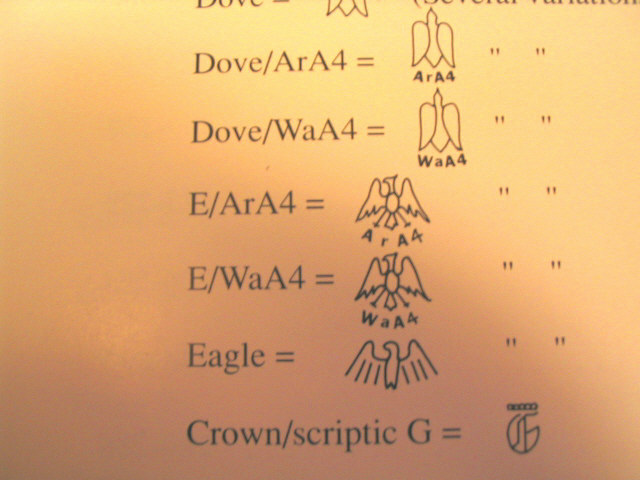

Over the chamber is stamped '1921' but no other numbers. The top of the toggle has the script 'DWM' stamp, along with the number 94. Frame and chamber both have the number 4794, and the 94 appears twice more on the left side of the pistol. The front strap of the grip, in rather rougher-looking letters, is stamped '4./K.3.99.' (I'm pretty certain that's accurate). On the right side of the chamber are stamped two little marks (side by side) that look like eagles, plus anoth mark I can't quite make out. On the right side near the toggle, however, is a similar-looking eagle stamp that has something resembling 'M9AL' beneath it. On the frame beneath the barrel appears to be a small, lower-case script letter 'a' (I think).

I am betting the M9AL is something like an HZa stamping that is smeered or not stamped well.

The proofs should match the ones shown in this photo
