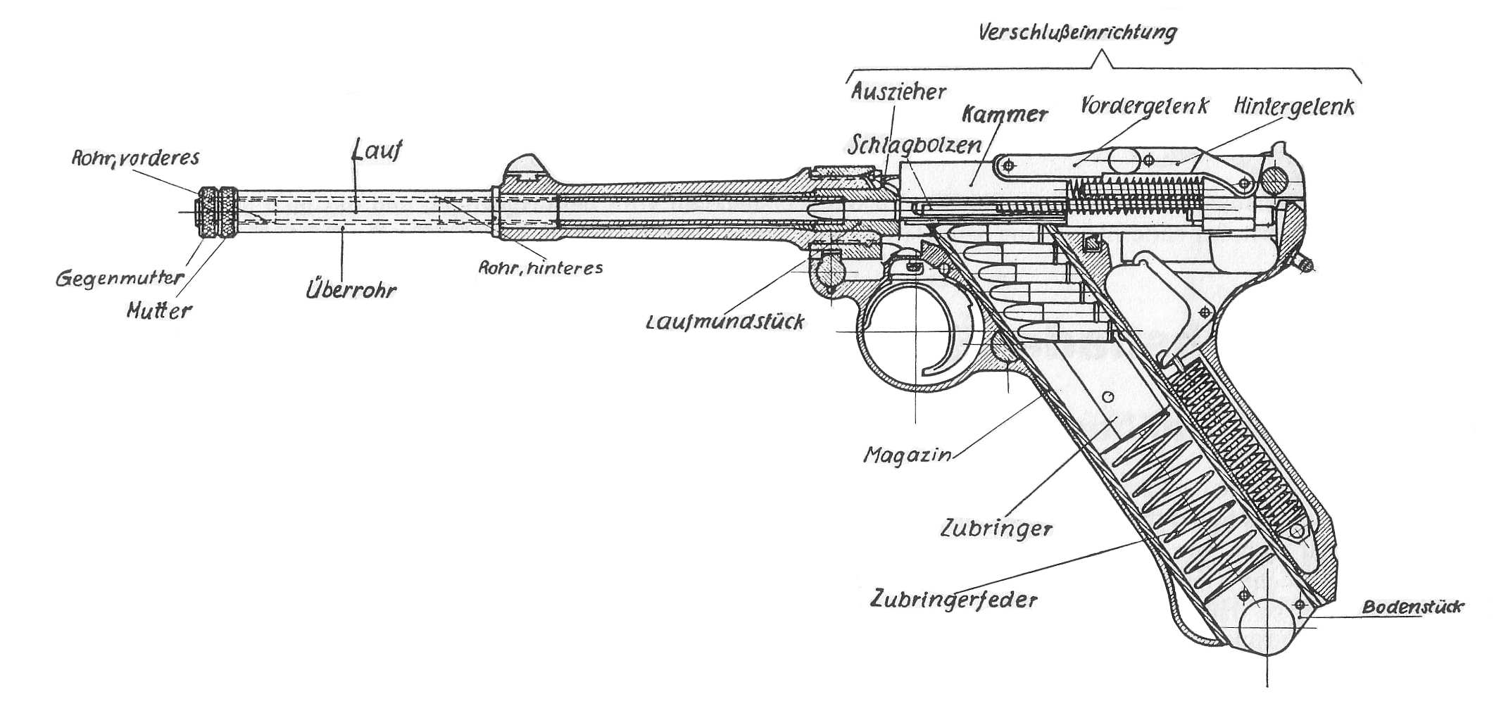

This one's a bit big, but should be interesting. A sectioned drawing from an old Erma Brochure:

Nice drawing Gerben!
