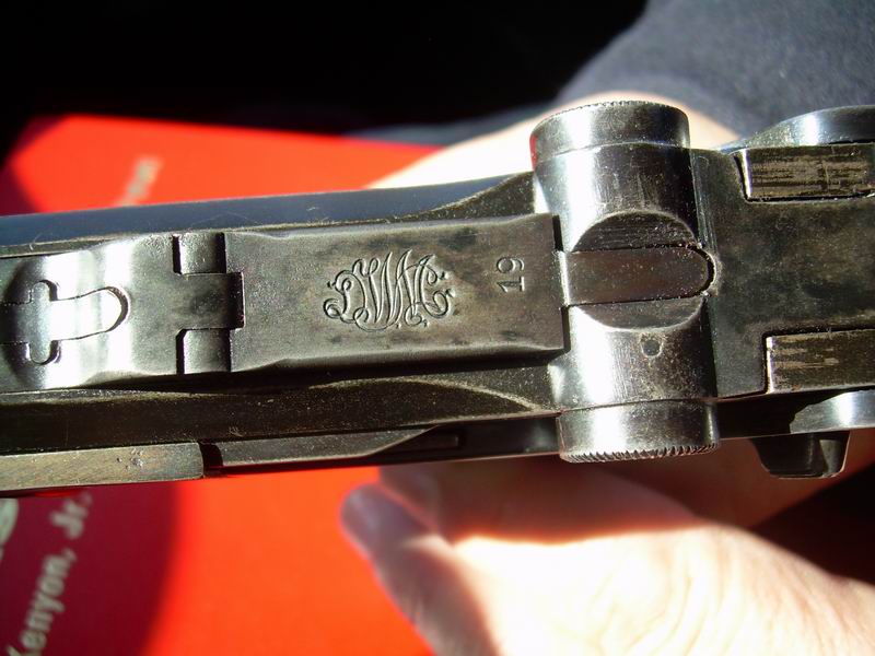

Anyway, I have found this DWM commercial with these uncommon toggles. Can you please help me to identify the gun?

Hi Alberto,

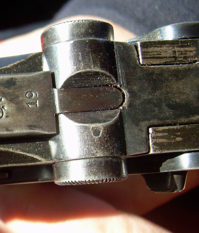

Could you post a photo of the top of this luger so we can see the front and rear toggle links in good detail ?

thanks for your kind answer. Here are the pics,

Alberto,
My guess is that your rear toggle link might be a spare part from the Swiss Model 1929 Luger made in Bern.
Here is what the rear toggle link looks like on a typical M1929 luger (photo is from the Simpsons LTD web site) :
QUESTION : Do yo see any faint evidence that the flat part of the top of your rear toggle link, behind the knobs, may have had some serial numbers stamped ?
Here is what the plain toggle "knobs" look like on a Swiss M1929 luger from a side-view :
Maybe your rear toggle link started as a plain Swiss one and had some machining and "dicing" pattern added to look more like the DWM type (???)
The other curious marking is on your luger's left-side receiver...just next to the normal C/N (crown/nitro) commercial proof.
I will let other Members speculate as to what this marking might be :

Pete,
the flat part of the top of the rear toggle link doesn't seem to have ever had any s/n. And the machining on the knobs look very "authentic" to be a late, non-original addition; weird...

Very odd. Notice that the "dicing" is at 90 degrees rather than the usual 60 degrees.

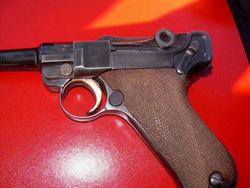

Alberto, notice the gaps in the fit of the elements of your toggle train. Compare your gaps to the tight fit of Pete's Swiss model. Your is an assembly of parts, hence the 19 on your middle toggle link. You would find out more if you posted pictures of both sides and showed the entire gun.
Unread 02-06-2007, 08:36 PM   #8
Alberto,
This is the pattern of verticle grooves you normally see on the outer edges of the toggle "knobs" of either a DWM, Erfurt, or Simson toggle.
Those grooves are missing on yours...thus my "theory" that someone may have started with a Swiss M1929 part which is also smooth along the knob edges...
Heniz has a very good point about the "gaps" in between some of the metal parts on your luger. Usually you see much tighter parts tolerances.

Al, Your rear toggle link is a DDR made replacement. The C/G indicates a Mauser or Simson rework of this C/N commerical, probably for the military during the late Weimar period. TH

Thanks again; your expertise truly awes me. Tom, may I ask how you know the toggle link is a DDR replacement? May the part not be a Swiss one,as it�´s been said above, to which the machining was later home added? And, please do excuse my ignorance, what does C/N stand for?

Al, In addition to having one of these spare unnumbered DDR rear links with the 90d knurling & uncut tops in stock, I've also seen them on several DDR reworks and on the new DDR "N" prefix production PO8s. According to Costanzo's "Proofmarks" page 195, the C/G proof indicates repair by Simson if it has a 5 pip crown and Mauser, if 4 pips are used. TH
