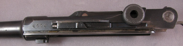

here is the left side of the receiver, showing the front side of the side plate and the sear bar

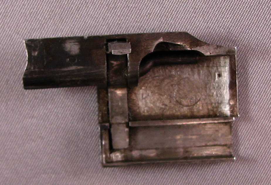

here is the sear bar that presses from inside the side plate to the sear

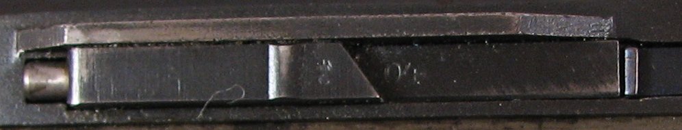

here is a close up of Simson #4004

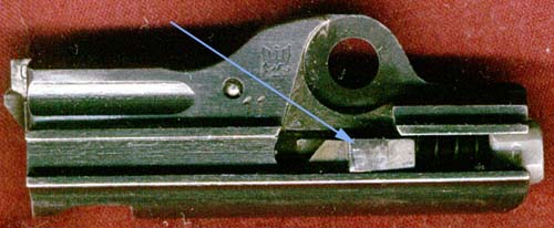

Take you Luger apart, and remove the toggle train from the receiver rails. In the illustration below you see a breechblock with the firing pin inserted; the Sear is the block on the firing pin which sticks out the slot on the left side, and is pointed out here by the blue arrow.

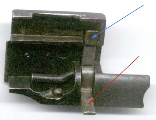

In the illustration below you see the Sear Bar in the left receiver rail, outlined in red.
Press inward (toward the center of the pistol) on the area pointed out in blue, you will see that the bar pivots on its center. If you look at the inside of the receiver rail, you will see that when you press inward, the back edge moves outward. This edge is what actually engages the sear on the firing pin.

Reassemble the receiver into the frame, and replace the trigger plate. As you do so, note the relationship of the pivoting, L-shaped piece of metal (trigger lever) in the trigger plate to the trigger and the sear bar.
As the trigger is pulled, it pulls down the leg of the trigger lever (red arrow), which pivots the top of the trigger lever (blue arrow) inward. This presses inward on the cylinder at the front of the sear bar, thus tripping the sear bar from the firing pin sear and firing the weapon.
