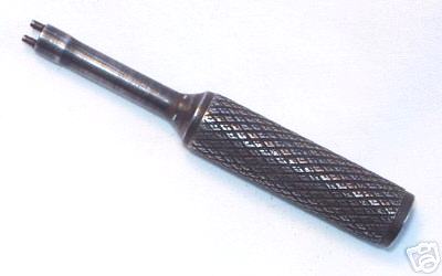

I've seen a couple of different site adjustment tools for sale recently and I'm not sure what is the correct type for a 1917 DWM Arty. I've seen them in brass and in blued steel. Does it matter?

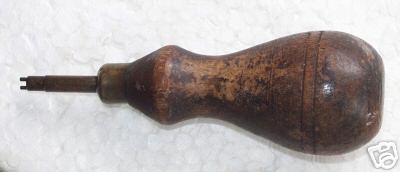

Neither are correct - they are reproductions. Normally a sight adjustment tool for a LP-08 would have a wooden handle for better gripping during cold temperatures while wearing gloves. The type I am showing hereunder would sometimes be found in an armourers kit, which also contained other tools for machine-guns, carbines and pistols.
A genuine sight adjustment tool is a difficult item to find and the value is about $300-$350. When examining a sight adjustment tool, play close attention to the two pins which must be perfect in shape. Albert |

Thanks Albert. I thought the knurled handles didn't look very turn-of-the-century.

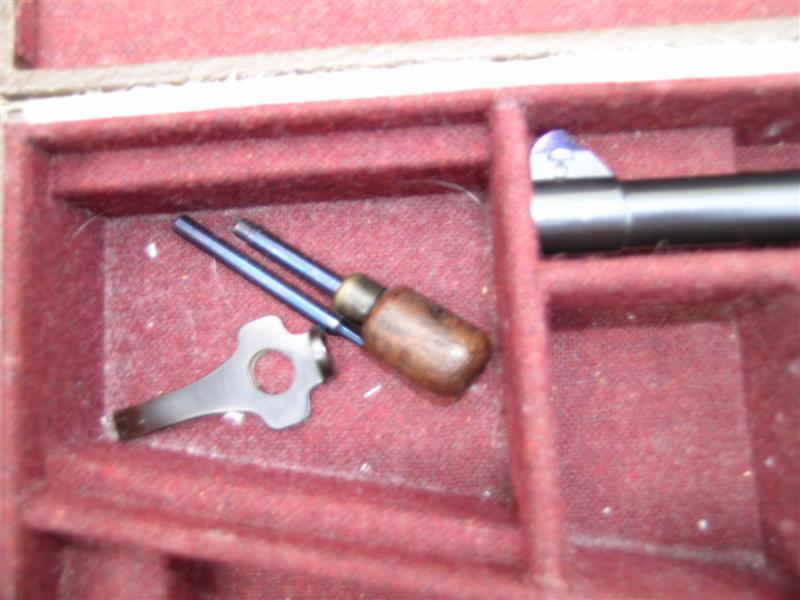

Shown below is another correct type of sight adjustment tool which is included with a cased Stoeger LP-08.
When examining any tool or accessory, it needs to be practical in its shape/design and function with various important factors in mind - that was the way of the Germans in regards to manufacturing during both wars. Good luck, Albert |

These are repros being sold on eBay and elsewhere :
http://cgi.ebay.com/GERMAN-LUGER-P-0...QQcmdZViewItem ![]() |

Pete, that's one of the ones I was looking at. He never says if it is or isn't but he does associate it with the real deal. With a $100 price tag, the uneducated (me) might suspect it's real.
