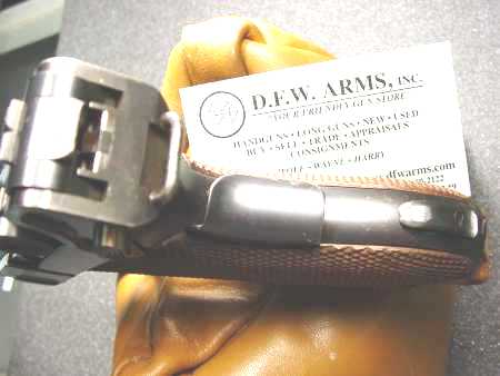

In the book Parabellum, (if I am reading it correctly) it states that to have "made in FRance" on the
barrel of an Abercrombie and Fitch luger makes it a fake since the gun was not made in France.
DFW arms is selling one marked as such and says the barrel is made in France. I am confused. Can someone clear this up for me? Thks

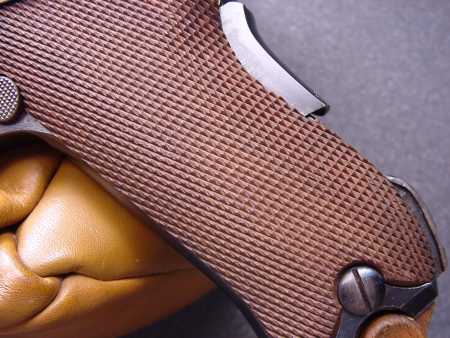

BTW...if this is the DFW lugers you are looking at, I think it is wrong. Certainly that "odd" stock lug added is not right.
I do not recall the other A&F lugers having a stock lug.
One also needs to question why the DFW offering does not have the 4-digit serial number on the left side of its receiver flat, as well. If I recall correctly, other A&F lugers do. This gun may have the 4-digits...but the glare of the photo makes it hard to tell or not.
A good photo of the front sight barrel band may be useful as well. DFW photos seem to crop out this important detail.
http://www.gunsamerica.com/guns/976525903.htm
Probably a product of the Luger Mafia... Or a local gun smith attempt to be able to shoot with a stock...???
