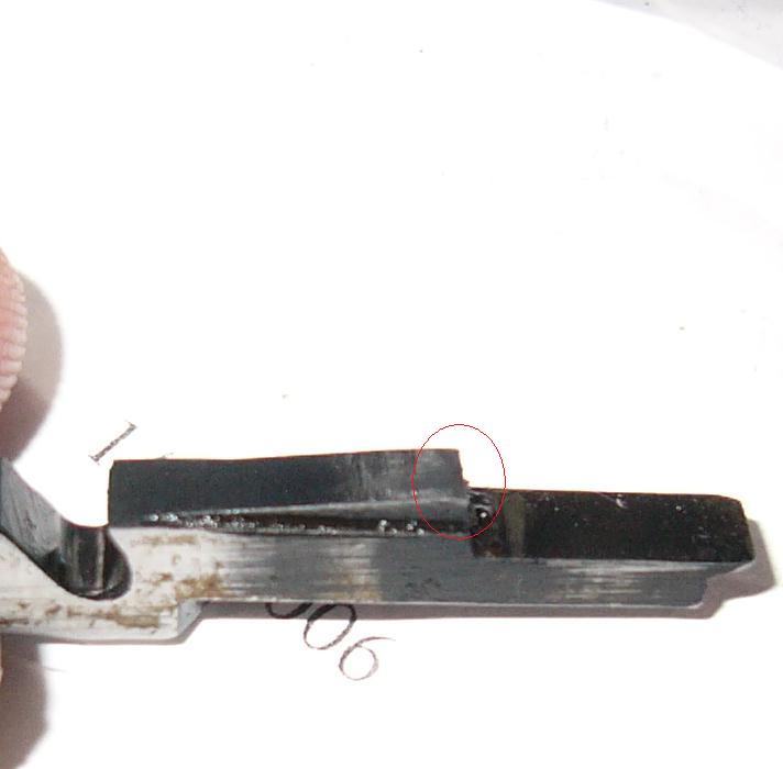

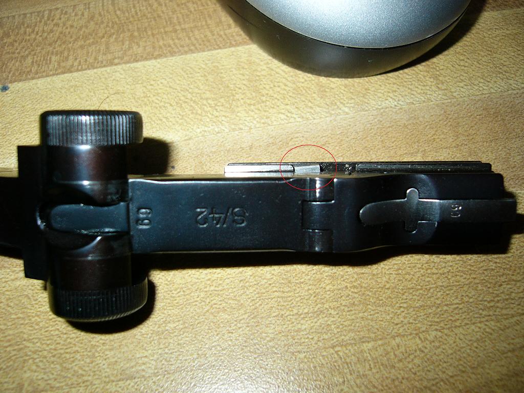

Its really hard to get a good photo of the wear on the sear. I'll post these and see what you guys think. Are there drop-in replacements for the sear and firing pin? If I replace these two parts I think I would be comfortable with the idea of firing the gun again.
Patrick

Here is another pic.

Sorry I live on the west coast, from pictures it looks OK, try putting it back together and see if dry firing you can recreate the doubling, still what about the firing pin, I believe once you stated it was bent??

After handling this thing for a while, and figuring out how it works, I think the side plate coming loose did cause the problem. It probably let the trigger bar stud pop back out or not depress at all during the recoil. I think I am correct in assuming that this is the reset mechanism that keeps one shot per trigger pull. So, however unlikely, the loose sideplate let the stud/plunger come back forward, but had enough pressure to disengage the sear from the firing pin(perhaps my thumb was on it) after the next round was chambered.
