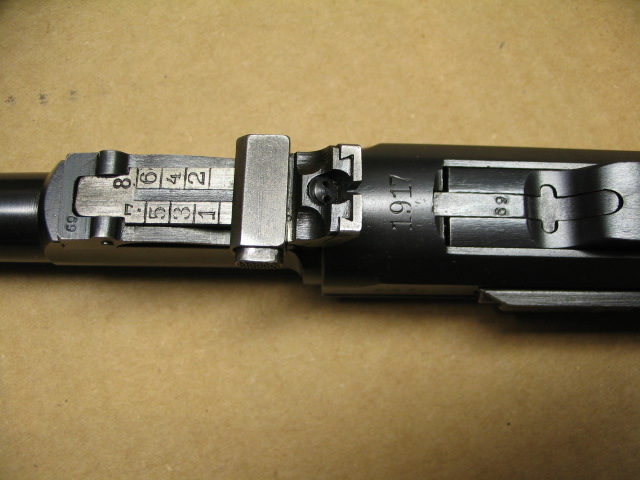

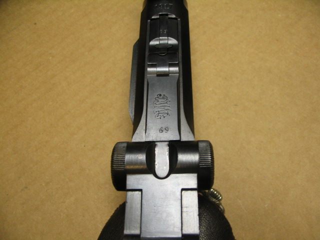

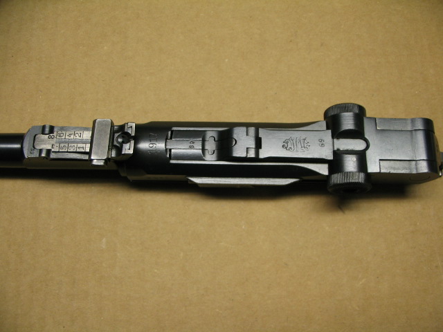

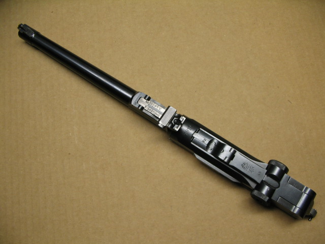

Jerry, a very sad story indeed... but a nice artillery top...

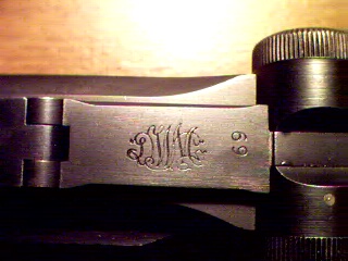

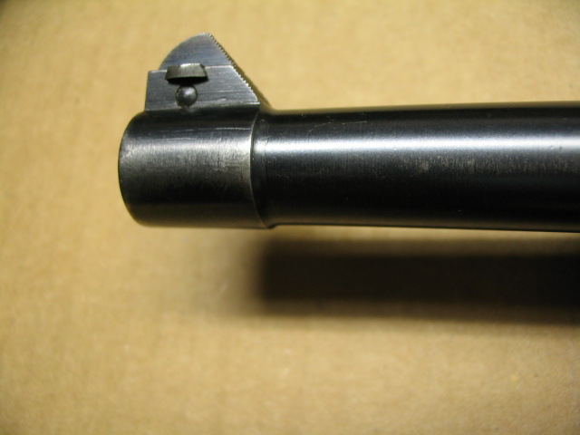

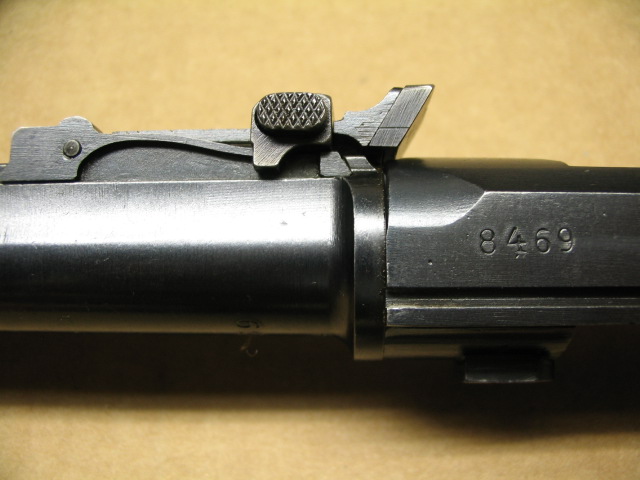

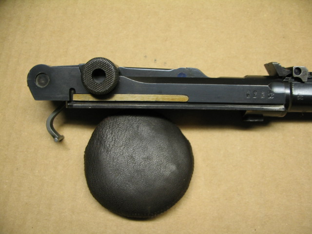

From the photos you were kind enough to post links to, I can make the observation that this Luger had been refinished at some point. It is a very well done refinish, but you can tell because the blueing is over some of the pitting that would have been too hard to remove... the DWM logo on the toggle is very thin (meaning not deep) indicating that the top of the toggle had been refinished. The bluing wear along the sides of the front sight band is also inconsistent with a pistol that should have had some obvious holster wear...
Please don't take this as really bad news because the overall assembly is in nice shape and you can certainly find a frame and associated parts to make this a terrific shooter example of an artillery... the likelihood of the ex-spouse relinquishing the bottom half is virtually zero... so building this back into a serviceable firearms is certainly the way to go. Even if someday hell freezes over and the bottom half is returned, you could always sell the parts you buy to make it complete and will probably not lose any money...
Put your needs in the Wanted To Buy forum and somebody out there in our membership will probably have what you are looking for. Since the bottom frame is the controlled serial numbered item, buying one will have to be treated as if it is a complete firearm and will have to go through a FFL dealer or if you are a C&R license holder, you can buy it directly...

You should be grateful that the wife wasn't any smarter. She removed the parts that are also found on any standard P08. A frame and sideplate are relatively easy to obtain. Finding a nice complete LP08 upper assembly is the really hard part.

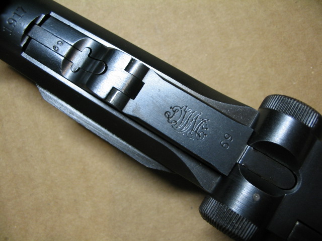

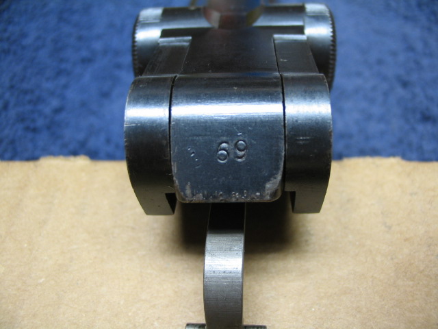

Hope I can explain this properly. I'd bet you a lunch that if you could hold this Receiver/Barrel in your hand you might have second thoughts on whether it has been refinished. I've added another pic under the originals that I took with a crummy webcam but it shows a few things that might not be visible in the other pics.
When I first noticed the thin DWM stamp I was concerned, but if you look at the last two digits of the serial# 69 you'll notice that they're very deep and show no signs of polishing, etc.; also some machining lines are present and the rest of the finish shows evidence of the "scratch" marks left by the circular brushes used in the rust blueing process.
I don't know if DWM ever let a shallow logo stamp pass final inspection but if you look closely you'll see the front edge and lower loop of the D is very deep, it's just the rear part of the M and the loops that are thin and directly behind that is the deep 69. Maybe the die was cocked? who knows. Also, my camera did not pick up the visible holster wear on the left side of the barrel and at the muzzle. But really, if you could see it in real life I think you'd change your mind.
This sort of thing takes me back to the 1960s and 70s when I had a pretty nice collection of Early Grip Safeties. It was relatively easy to spot a pistol that had been refinished. It was almost impossible for even the best gunsmiths to replicate DWM's rust blueing process in my opinion.
I'd be willing to send this out to you or anyone who really knows their finishes and if I'm wrong I'll buy the lunch.

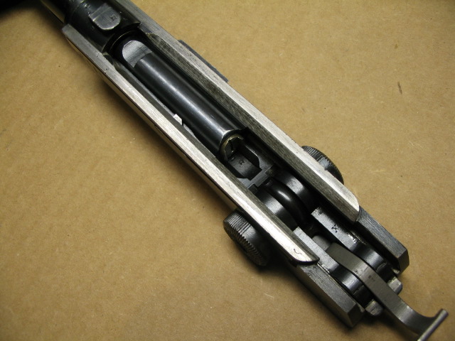

John, I have to agree with Jerry, I don't think this has been refinnished. The frame rails are in the white as they should be and it would take an astute refinisher indeed to leave that detail. Jerry Burney

I have to come in on the side of the non-refinish opinion. The toggle axle retaining pin is still in the white and the serial numbers exhibit a halo. To my eye it looks like a pretty pristine original. Welcome back to the fold. I don't know how you held out for 22 years. Grip safety models rule!!

I never felt is was refinished and so never touched on that subject.....so let me add/state it is as mint original as you'll find.....best of luck.

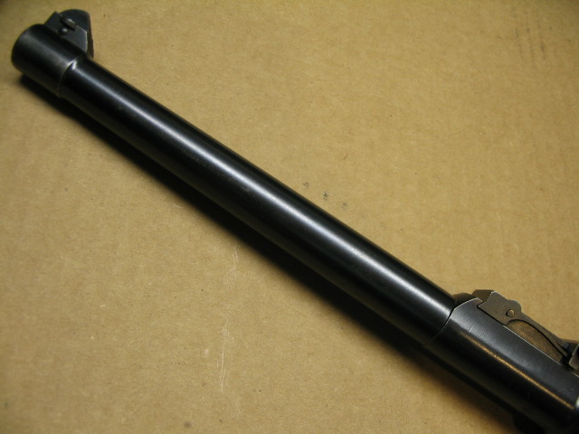

I submit to the consensus of my esteemed colleagues... but I still think the pitted areas should be closely examined with a jewelers loupe under appropriate light to see if the bluing is over the pits...

John, thanks for the submission, seriously though, when you mentioned pitting it threw me off because there is no pitting whatsoever anywhere on the piece. If you're referring to the area on the rear toggle link below the 69, (pic# 2320) that's just, unfortunately, blue wear and some dings in the metal that show white metal under the blue, it's definitely not pitting. If you mean another area please let me know which picture.
