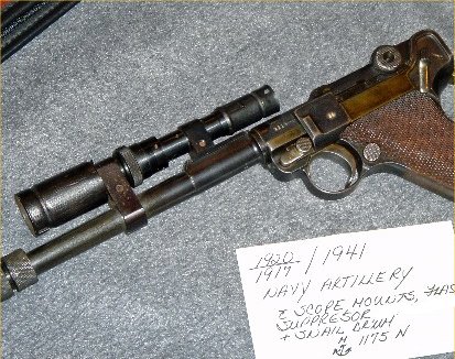

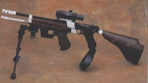

A fellow Luger collector sent me this picture today. I found it very interesting, so I thought I would share it with the forum. He was visiting another collector in hopes of capitalizing on a rumor of a collection being for sale. He found the collection, but has not yet informed me of any money changing hands. This is one of the Lugers in the collection. Any comments???

Nothing more than a curiosity. While most likely an original LP08, it is probably a US gun enthusiast's enterprise put together in the years following WWII. If it is truly a navy job as indicated on the index card it is a real shame because the junk added to it destroyed most of the original value. Let your friend know that a wire skeleton stock attached to his pistol is likely to get him thrown into the "slammer".

I agree with George, if a wire stock is used with this pistol it is absolutely illegal under the NFA unless this gun has been registered with the ATF as a short barreled rifle and the $200 tax has been paid... I would not spend any time with the owner of this gun unless I has seen the paperwork. There are also no "grandfathered" guns that are exempt from this act... only specific C&R exemptions... this is a home "gunsmith" or machinest project... nothing more.
Mere possession of this gun with a wire stock would be a federal felony.

I'm not so sure that I would pass this off as a "Bubba Job". The scope is period correct. The work appears to be very proffessionaly done.
Until I could see it hands-on or see much better photos. I'm not so sure that it may not be original. I like it. If it were to come up for sale? I wouldn't hesitate, at the right price.

This Luger Arty customization was made by W. Aulke in Germany around 1970.
In the attached photo a scan from my copy of DWJ dated September 1971.
We already discuss this kind of customization around one year ago.

And the lesson is, we now know it is a 1970 German alteration and it is going to be "coming out of an old collection" with "provenance by a long time collector" (the file card). Tuition at Luger U is high. Be careful.

I don't see any mention of a stock on the card. Maybe I missed something. The photo does not show the so called flash supressor very well. Maybe it is a bore brush. Many people don't know what a bore brush is and may confuse it with a flash supressor. I would not want to shoot this gun with a bore brush screwed on it. The card only says that it comes with a snail drum.
While I have seen large caliber pistols with scopes on them that are used for deer hunting in southern Michigan, where rifles cannot legally be used, I cannot understand puting a scope on a smaller caliber pistol. Pistols are essentially short range weapons and so I cannot understand why a sniper would use a 9mm pistol with a scope. Every sniper that I talked to always bragged about their rifles. In Nam and in Korea, snipers had a choice of weapons that they used.
The only legit and unusual accessory to a LP-08 that I have ever seen was a mount with a brass flash light that Doug Smith of FGS once bought. It mounted on the underside of the barrel and would have had some wires running from it to a battery pack that would have been on a belt. Doug did not have the battery pack.
