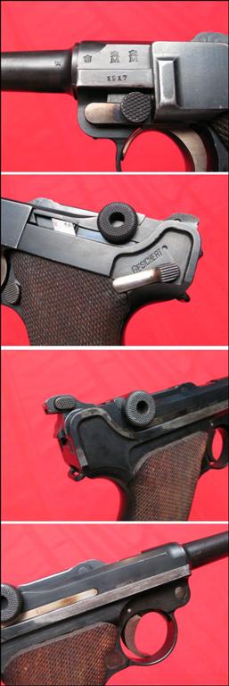

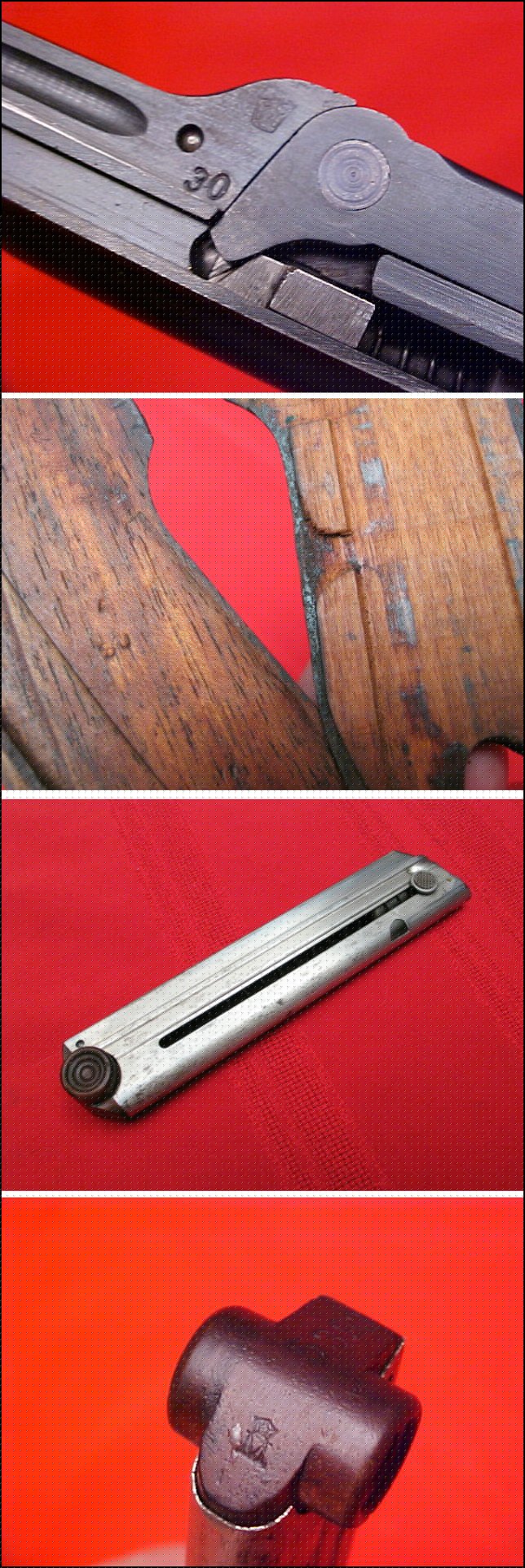

Wonder what the rear toggle pin flange looks like...???

The picture quality and selection is such that I believe I detect evidence of refinish. I also suspect that the rear toggle flange will be found to be correct.

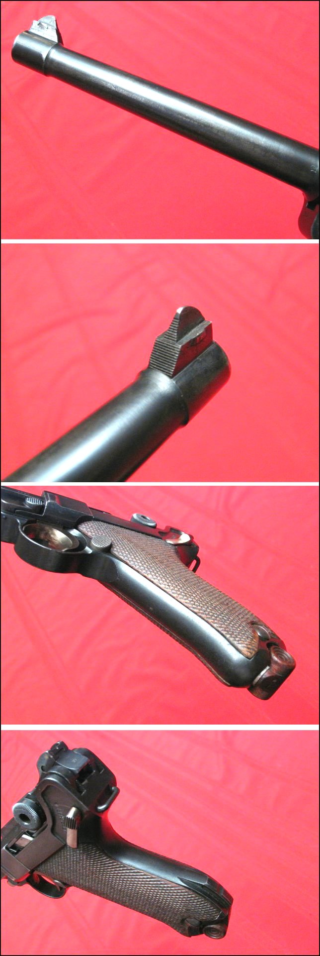

I do not know if the front barrel band transition to the barrel is correct...looks a bit odd.
The depth of "1917" on the chamber may indicate a refinish sometime.
The lack of a smaller "1917" on the left side of the front sight base is worrisome as well...IMO.
