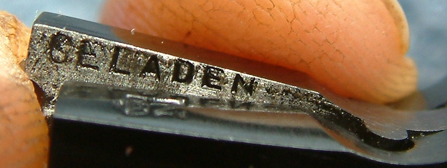

Default P 59
Geladen on 9mm breech block.

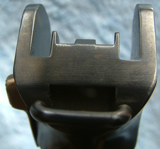

Default P 59

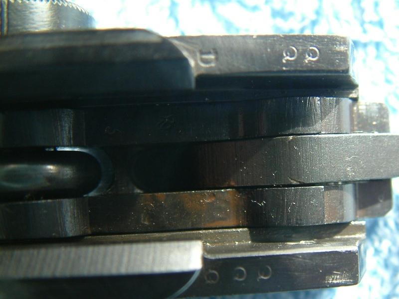

Rear underside of 9mm fork shows (5) Q's and another inspection mark of "D" quite plainly

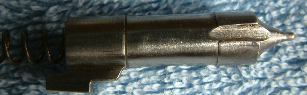

Fluted 9mm firing pin. The 7.65mm pin is not fluted, but has a relief hole drilled in the bottom side of the breech bolt to vent downward.

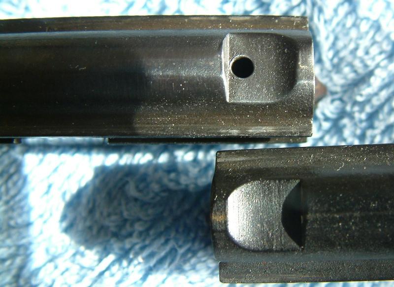

Default P 59
Note the difference in the bottom of the breech blocks. The 9mm has no vent hole and the 7.65 is vented downward.

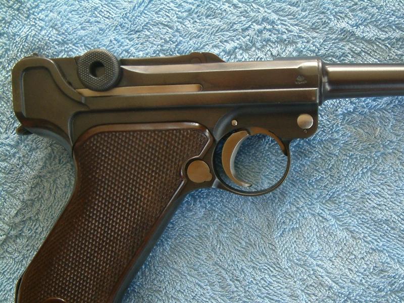

Right side view of frame.
Unread 01-31-2006, 01:40 AM   #28
hqbmw
Join Date: Jun 2005
Location: Mesa AZ
Posts: 228
Default P 59

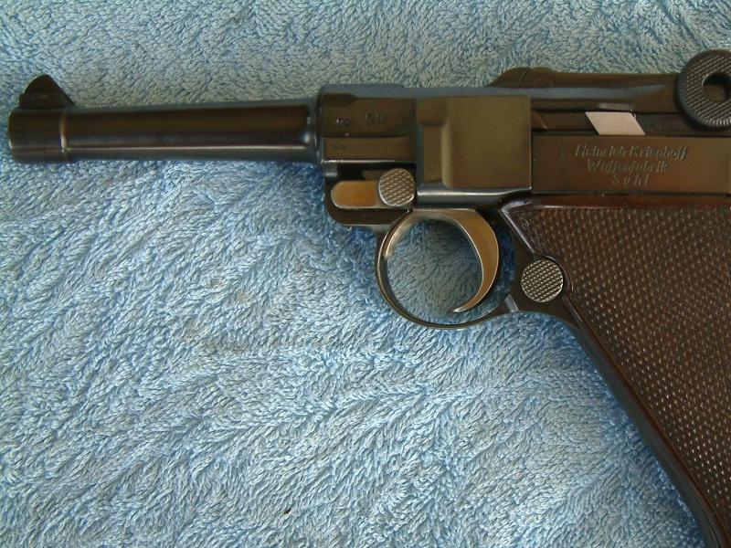

Left side of frame

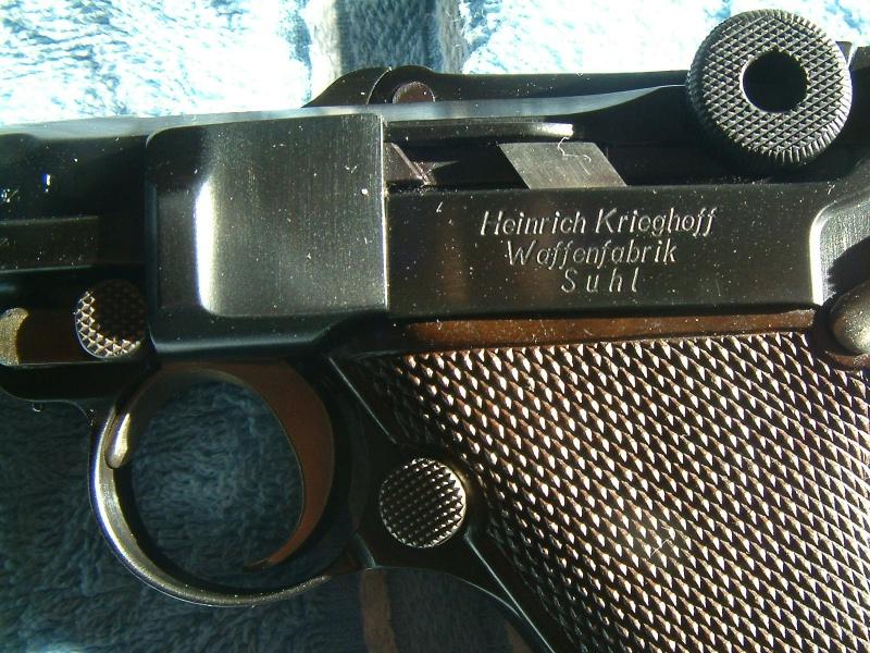

Jack,
Can you post detailed, close-up and in-focus photo of the proof/staming on the right side of the receiver and the inscription on the left side panel...?
Thanks...

Unread 01-31-2006, 11:04 PM   #36
hqbmw

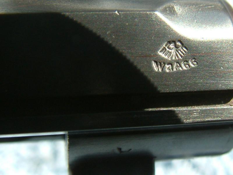

Default P 59
Right side of 9mm 100mm long barrel. Note the rare WaA66 proof mark. Keep in mind that this canon has the hole(s) filled in on the left side rail where the police sear safety was installed or meant to be installed at one time.

Posts: 228
Default P 59
Left side plate: (with dust! I could have been a bit cleaner!)

Unread 02-01-2006, 12:25 AM   #39
Hi Jack,
I know next to nothing about production HK lugers (having a sole S-code in my collection...) and 100% less about the P-series HK's...however...I would ask these questions :
1. Is the shallow bevel of the holes in the toggle knobs appropriate ?
Here is a photo John. D posted of his P183 commercial HK back on 10-22-03 in the HK luger section on the Forum :
2. I thought the 5-point HK rejection stars were stamped. Your photo appears to show an engraved star that is not symetrical in the width of the engraving. Should the star be stamped or engraved to be proper ?
And his side inscription in detail :
3. What is the WaA66 stamping all about...?
Waiting for John D. or Tom A. to contribute...
Unread 02-01-2006, 12:34 AM   #40
Imperial Arms
Banned
Location: Malta, EU
Posts: 579
Thanked 9 Times in 9 Posts
Hello Jack,
While I am not an expert with Krieghoff Lugers, your Luger gives me 'bad vibes', and it could be restored. Firstly, something appears strange with the sideplate and, secondly, the straw is inconsistent on the various parts. I would like to hear the opinions from members on this forum who have more knowledge than I on the subject of Krieghoff Lugers.
If my observations or opinions are incorrect, I apologize for making a bad judgement. I am aware that some members are shy with giving constructive criticisms to Lugers which belong to fellow collectors, however, if you are asking for the opinions of collectors on this forum, try to keep an open mind without becoming angry or disappointed.
Albert
