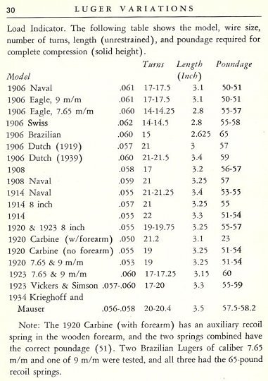

There is a main spring chart around here somewhere.(below) It has recommendations for all kinds of lugers. It sounds like you have adjusted one before - they are tricky! (not speaking from personal experience - that's something I have yet to try!)
There are springs and then there are real springs. Wire size, composition, coils, etc all make a big difference. After market springs are a gamble, so don't be afraid to swap out the extractor spring again. I'd certainly do the before adjusting the main spring. My felling is that if any rounds cycle normal, the main spring is probably set correctly.
Focus on that magazine a lot. They are very hard to eye-ball or even measure. They have to fit exactly right and not move around once they are locked into place. Lots can go wrong with a magazine. It's a critical part.
