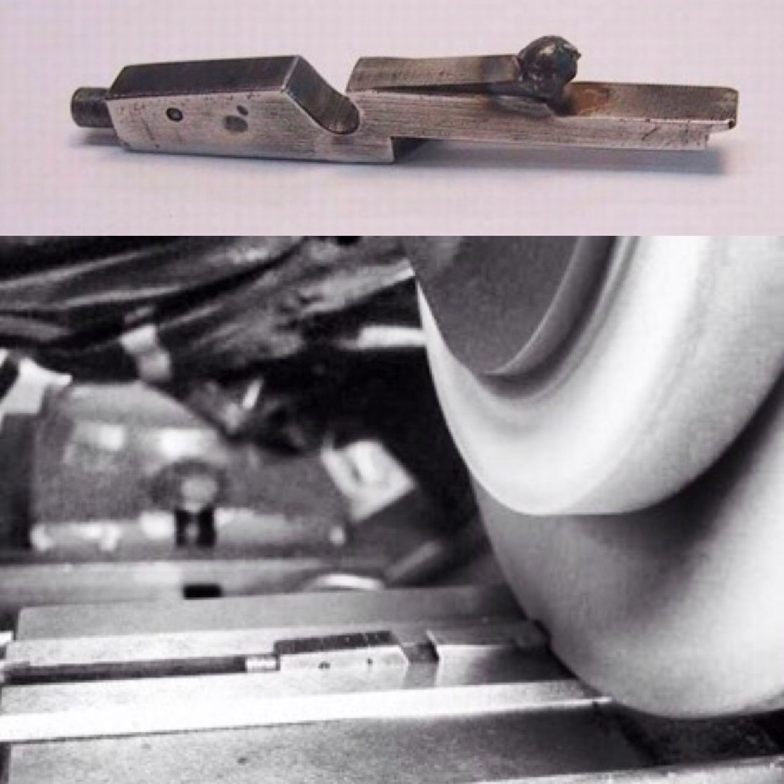

I weld up sear with hardening welding vire and grind it to blueprint.
Checkering is 50LPI and that is really on my limit!
Both for my eyes and the filing is difficult to
Spuhr is offline   Reply With Quote
