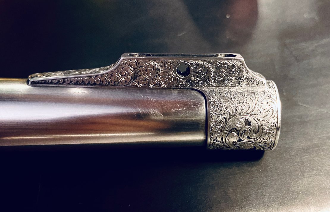

Started this a few years ago as my wife wanted a heavyer targetluger like the one I use but a tad lighter.
She was requesting a round barrel.
Barrel is made in one piece including the front sight base.
Front sight base will later contain a elevation adjustable front sight.
Gun is built on scrap, no nice collectible matching museumpiece have lost its life here!

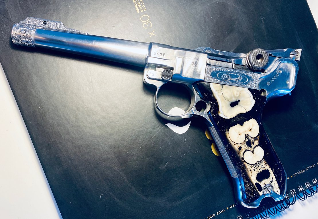

Grips are made of stabilized hippo jawbone.
Of her choise.
I have the drawings but I had to tweak it considerably to get it to work. So several pairs of wooden grips was made prior to those

PLEASE POST A PIC OF THE FINISHED PISTOL..THANKS
