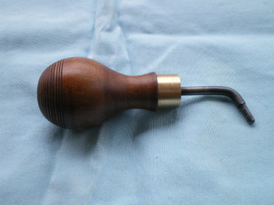

Very easy with this tool : 2 mn to remouve and instal again the spring
Jim's tool available through this thread (which should be a sticky)...
http://forum.lugerforum.com/showthread.php?t=31945
