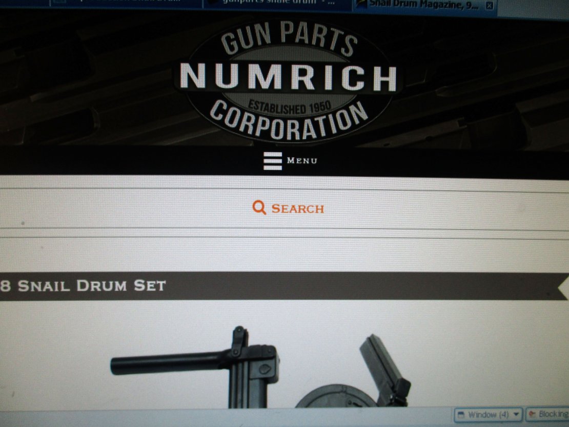

I took a look~ http://www.gunpartscorp.com/ad/980980.htm
