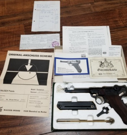

Here's a few quick photos of Mauser Parabellum pistols with the scarce 5 inch (12 CM) barrel length.
Photo 01 shows the sure fire way to identify the 5" barrel variation-it doesn't fit the styrofoam box! Notice the crude chunk torn out between the 4" and 6" front sight locations.

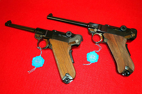

Photo 02 shows this pistol next to a Model 29. I would say this pistol-10 004558-is as close as Mauser ever came to duplicating the M29.
