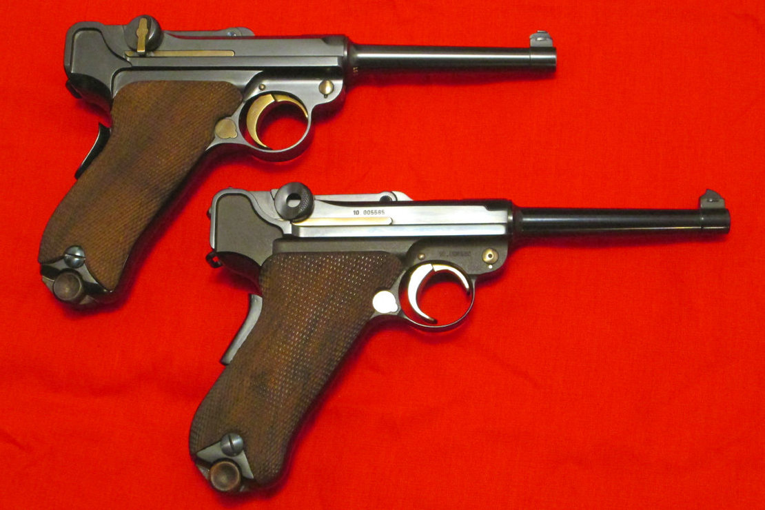

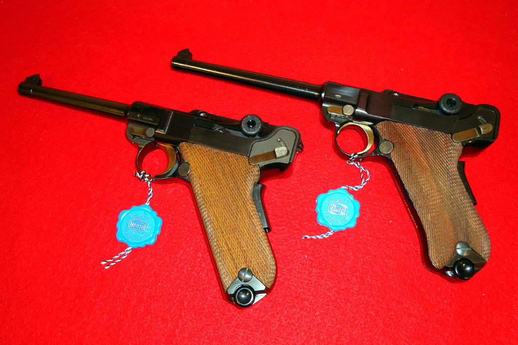

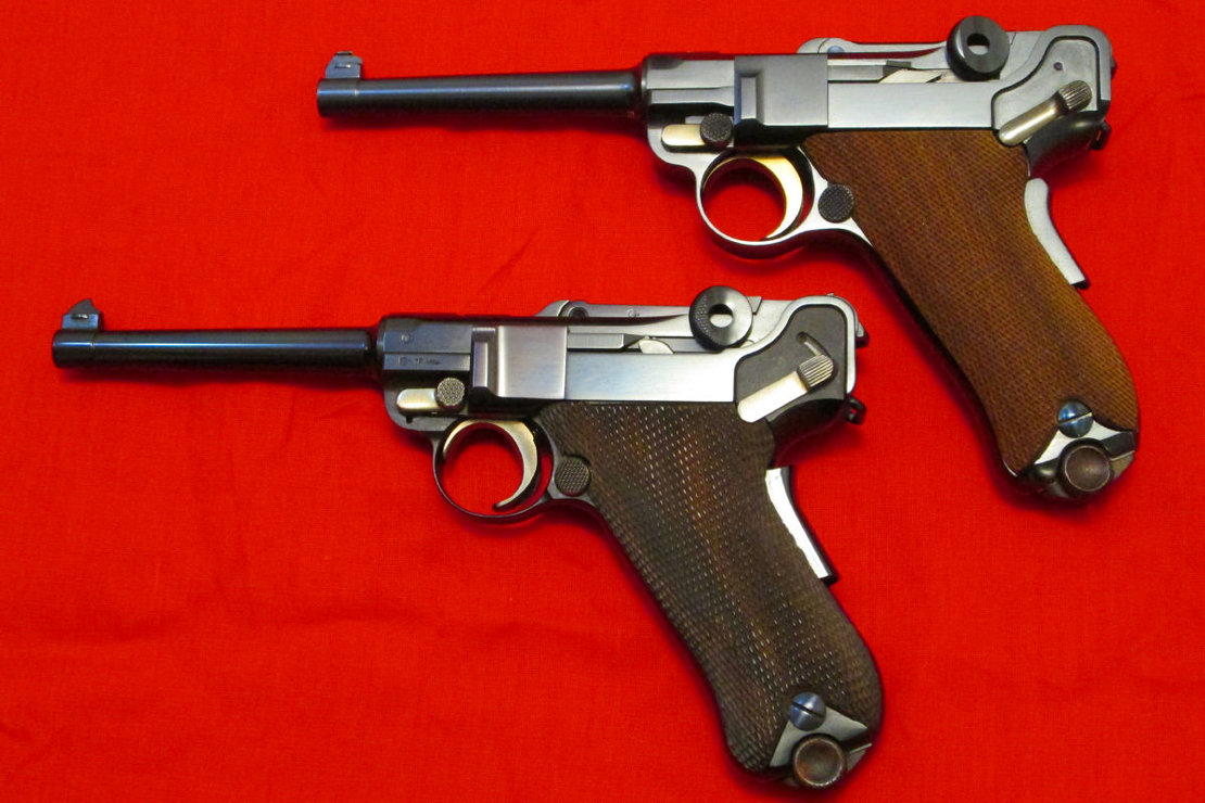

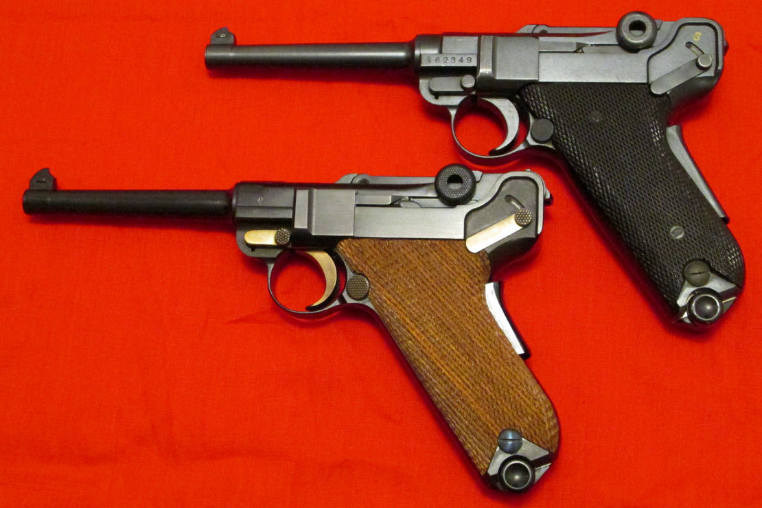

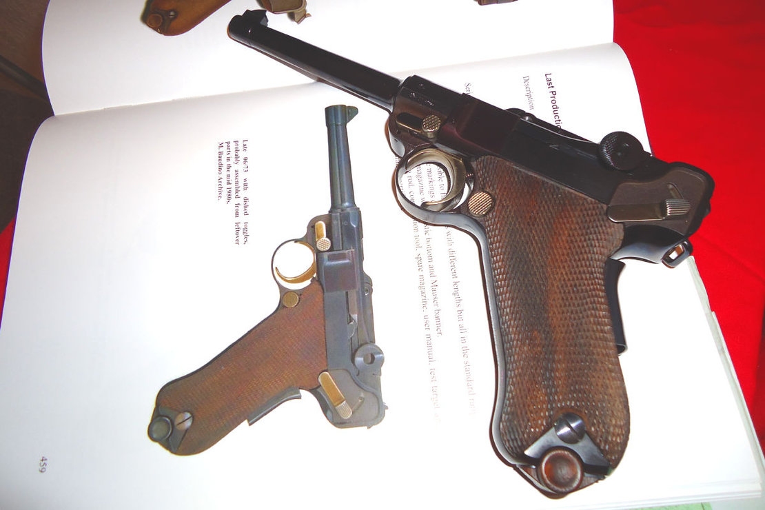

Here's a few quick photos of Mauser Parabellum pistols with the scarce 5 inch (12 CM) barrel length.
Photo 01 shows the sure fire way to identify the 5" barrel variation-it doesn't fit the styrofoam box! Notice the crude chunk torn out between the 4" and 6" front sight locations.
Photo 02 shows this pistol next to a Model 29. I would say this pistol-10 004558-is as close as Mauser ever came to duplicating the M29.
Photo 03-moving up 50 numbers to 10 004618-is the same type except with P08 style safety. Shown next to regular 6" length 06/73.
Photo 04 shows a 5" "Last Production" variation made in 1985 on it's related page (459) in "The Parabellum is Back", our must-have reference book.
Photo 05 shows this pistol with a 1900 AE. I could call this a "First and Last" Luger photo-spanning from @1902 to 1985. Kind of ironic the "Last Production" Luger harps back to the first model with the 1900 style dished toggle.
Photo 06 is just the other side of these two pistols.
Hope you enjoy these, best wishes, Joe

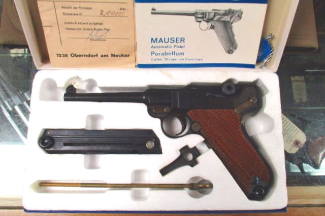

Here's why I asked about 10 004515: after I started this post a few days ago I did a Google image search or two-looking for evidence of more regular production .30 pistols with the scarce 5" barrel.
(I had done similar search months earlier looking for another nickel plated Mauser Parabellum (image 00) with zero results.)
Image 01 is a screen shot of one page from the search results-row one shows a 5" but its a commemorative. I saw, in the bottom left corner, what looked liked another regular production 5".
It was linked to Frontier Gallery LLC, a well known dealer in Colorado and a regular at the annual Colorado Gun Collector's Show (cancelled this year due to coronavirus).
Frontier Gallery moved from Denver to my hometown of Fort Collins a few years ago---what a coincidence---that I found another one of these ultra-rare pistols-still for sale-right in my hometown of all places!!!
Due to coronavirus panic buying it took over 2 days to clear the background check, but I took 4515 home last night. The pistol has really nice wood grain on the grips and could hardly be in more pristine condition. (Image 02)
By chance if anyone has what Vlim said is the more common 06/73 with a 5" barrel to spare and wants one with a Swiss frame perhaps we could do a trade.
Best wishes to all, Joe
