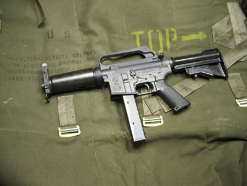

The only exceptions are the one I detail above and the rare M231 Port Firing Weapon.
...And the 9mm Colt M633...(Adopted by the DOE)...

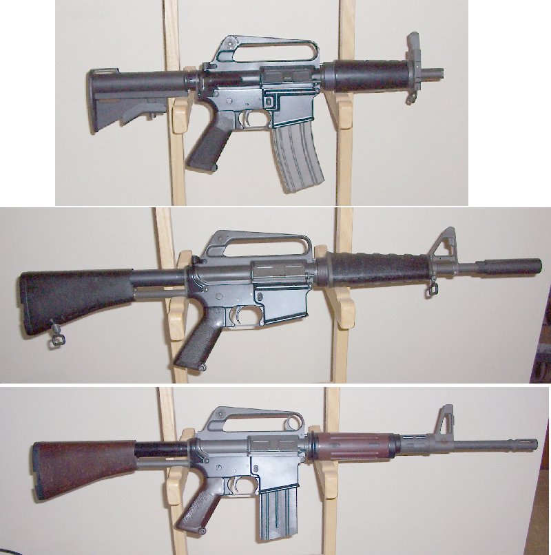

Yes, but I don't consider this an "AR"
A few years ago, when I was heavily into 80% receivers, I did several clones of old AR's...The M633, the XM607, and a 'fantasy prototype' based on several of Reed Knights collectibles...All in 5.56...
The 5.56mm M633 clone is a crowd pleaser...
Unread 03-22-2012, 03:29 PM   #13
All nice replicas!! I've toured Reed's collection and it is quite impressive. In fact, the last time I visited I was in the company of General Kalashnikov, who remarked that he was also very impressed with Reed's collection, but puzzled by the lack of AK variants. Reed has no Ak variants in the lot!!
The M607 should have a 10" barrel and the first issue sound moderator with no flash hider, but pretty close!
