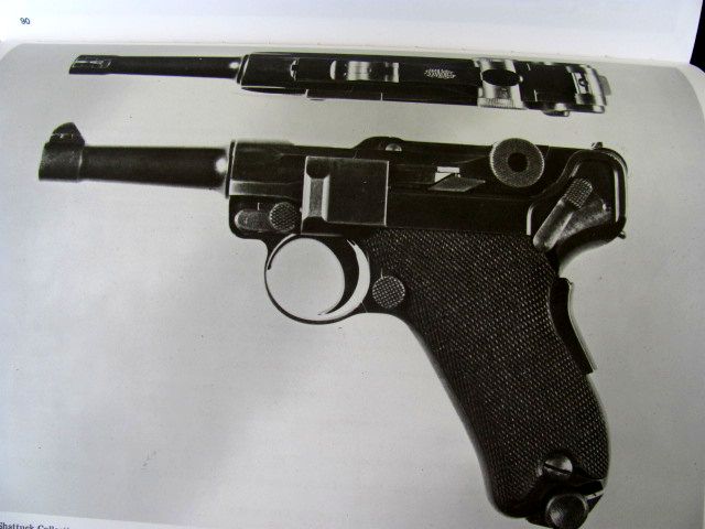

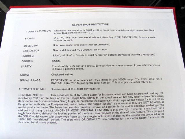

How about the shortest barrel? Looks like Ralphs' 'seven shot prototype' 3 1/4 inch built by George Luger for His personal use
Unread 01-26-2011, 10:46 AM   #6
Thor
Thor's Avatar
Posts: 4,583
Thanks: 958
I think I have seen a couple of 2" models and dont forget the 32 and 380 Babys.
