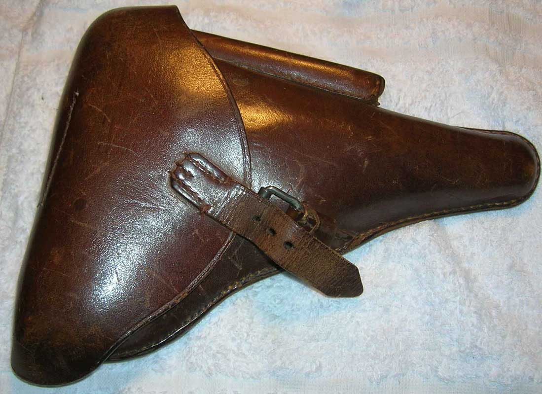

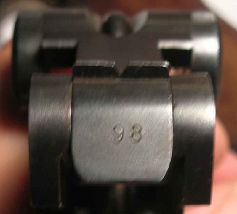

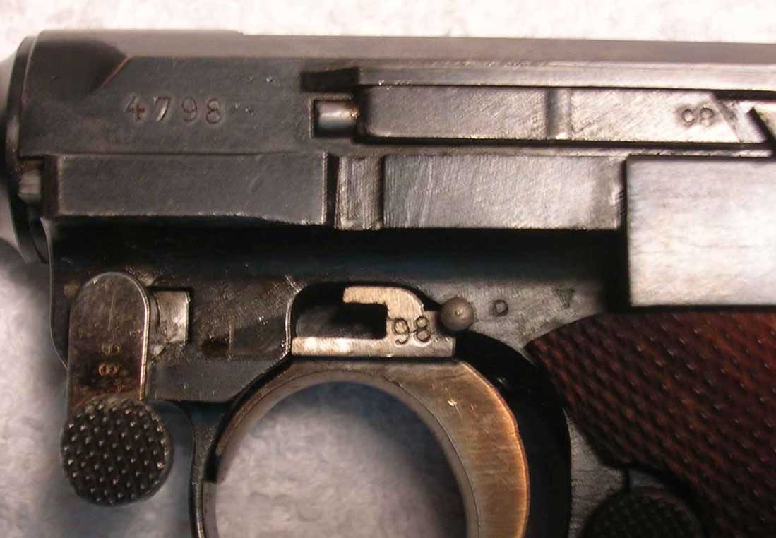

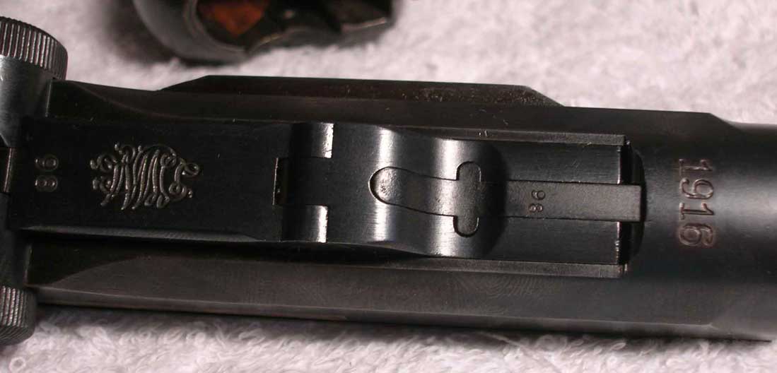

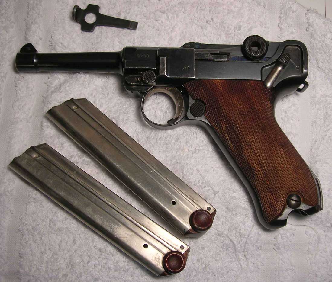

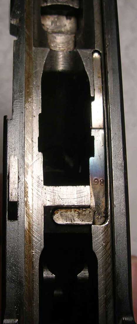

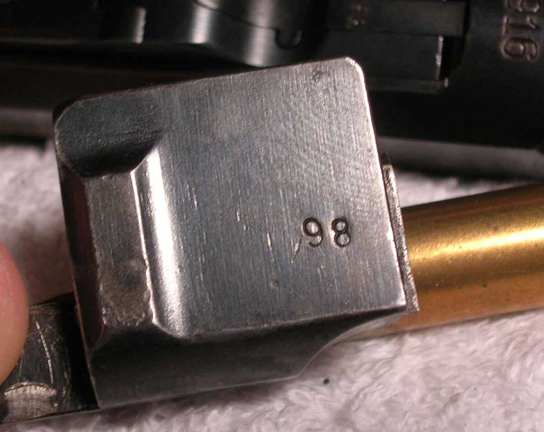

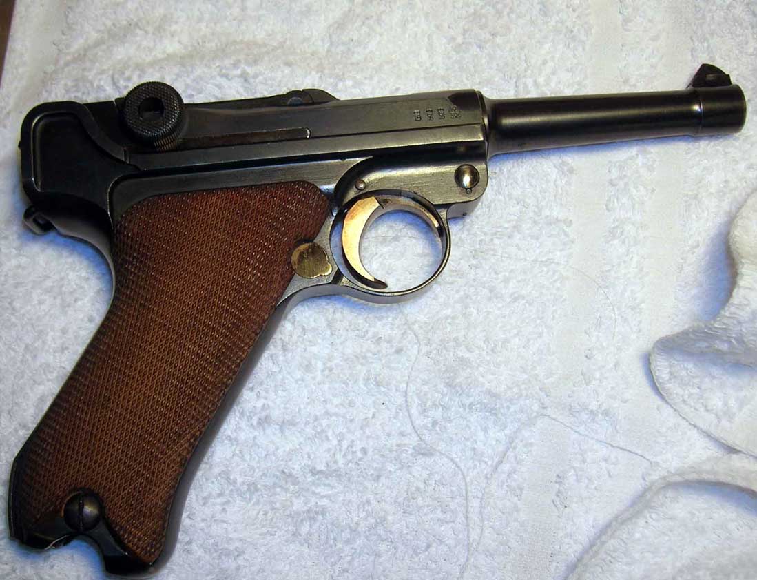

On condition and value of a 1916 dated DWM luger with 2 magazines (original?) and holster and tool that a friend of mine picked up from a gentleman in his 80's, that he had brought back from the war.

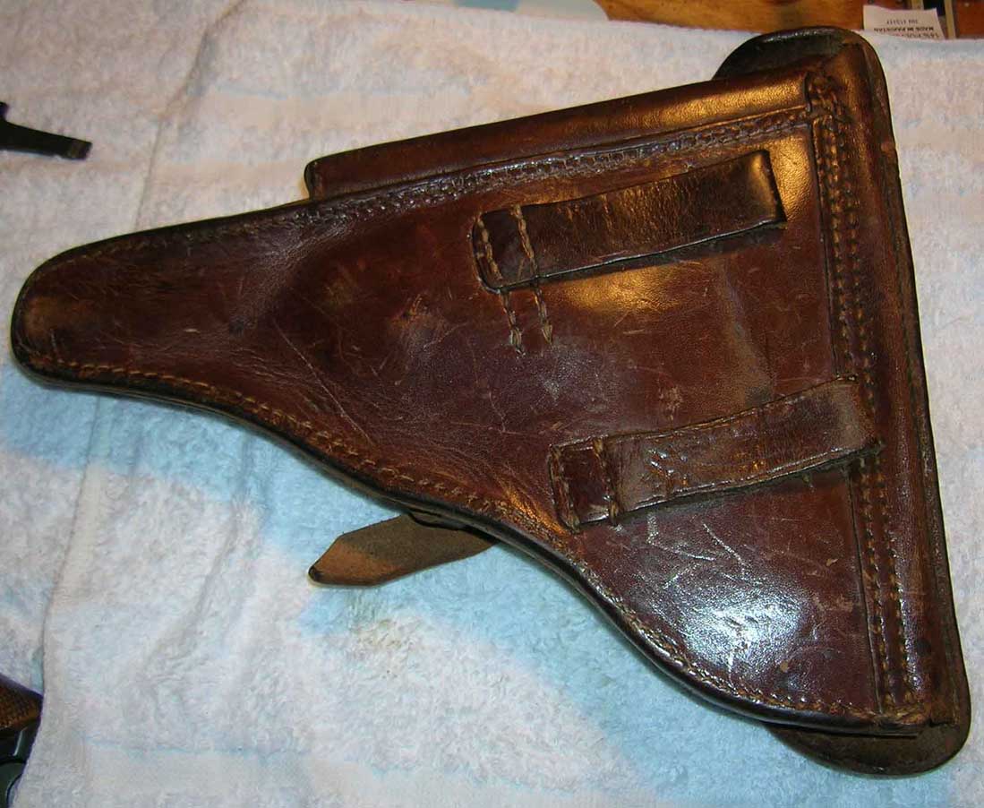

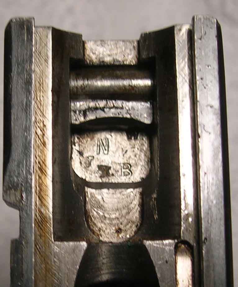

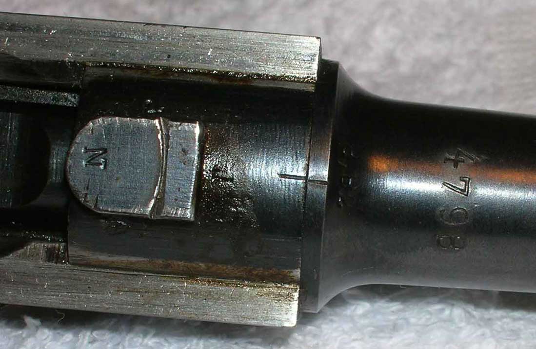

All matching (appears to be, check firing pin), with 2 matching mags, and tool and nice holster.
If original and appears to be, probably $2500-$3000
(Just as an FYI, if no matching mags, then $1200-$1500, plus $250-$300 for the holster); matching mags from WW1 are unsual and have been faked, they will want to be looked at close.

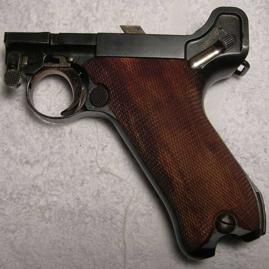

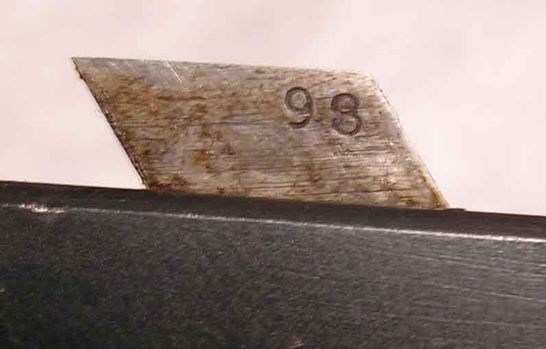

Does that witness mark look right or is that just a matter of the camera angle?
Mauser720 - Ron
Unread 07-21-2009, 01:19 PM   #7
Brkdnc
Posts: 11
Looked OK to me at the time, but I don't have it to take a closer look at.
Brkdnc is offline   Reply With Quote

A great matching rig as this, in prime condition, and this is, will bring min $3,800.00, even in these trying times......an 1916 rig just does not get any better......thanks for sharing it

I'm not an expert but it seems to be a wonderful rig. If mags are original and not reblued or refurbished you have a treasure. Don't sell at any price.

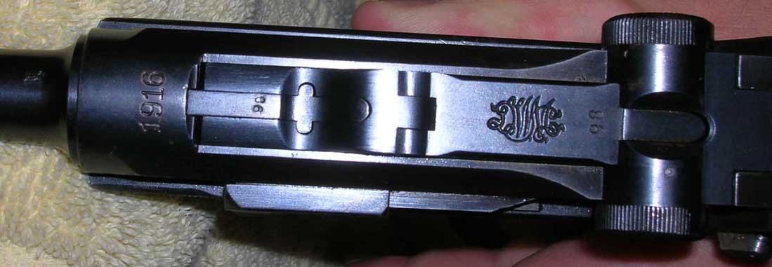

Should we see a suffix on the mags, assuming that there is one on the frame?
Unread 07-21-2009, 11:06 PM   #12
Not supposed to carry suffix because the barrel has no suffix. The frame does not supposed to have sufffix either.

Why no suffix on the frame? Is it a year of mfg. thing?
Unread 07-22-2009, 12:07 AM   #15
rolandtg
rolandtg's Avatar
Join Date: Mar 2007
Location: Texas Hill Country
Posts: 481
Thanks: 399

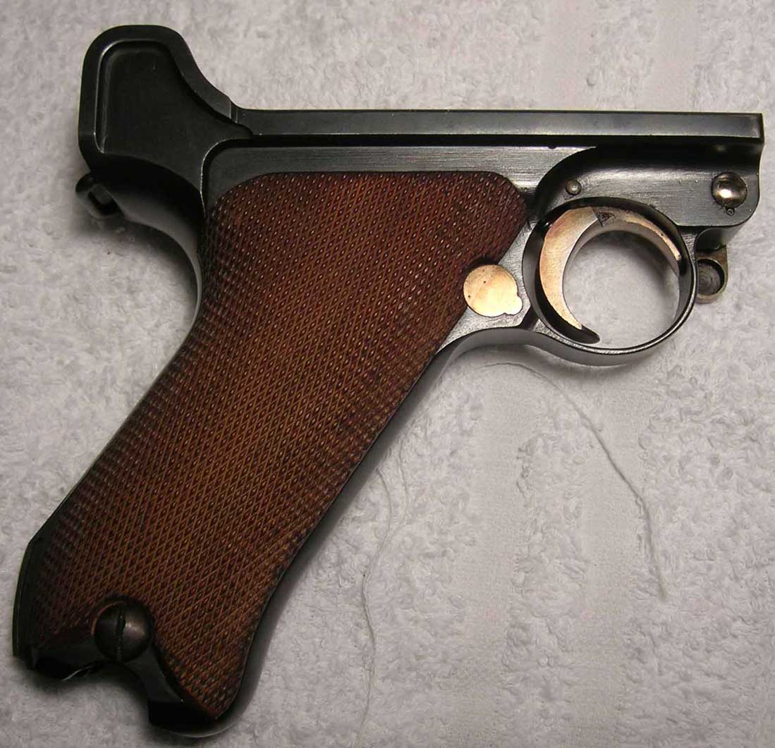

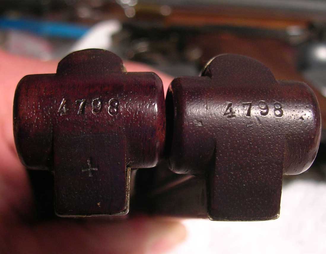

Very, very, pretty! Are the grips also numbered to the gun?
Unread 07-22-2009, 12:27 AM   #16
First run of 10,000 guns carrie no suffix
Unread 07-22-2009, 01:01 AM   #17
Brkdnc
Posts: 11
WOW, I didn't know they numbered the grips also. I will have to see If I can get him to bring it back over and check the grips and the firing pin and give it a cleaning while I am at it, it needs it if you didn't notice it in the pictures.
I am pretty sure they will match but only one way to know for sure.
Unread 07-22-2009, 10:07 AM   #18
Please, PLEASE be careful in removing the left grip especially. Hundreds of grips have been chipped right where they meet the safety lever due to prying up or impatient removal.
This would be almost criminal on a pristine rig like this one.
Work on each grip by tapping gently and evenly from the inside through the magazine well with a non marring object like a wooden dowel.
