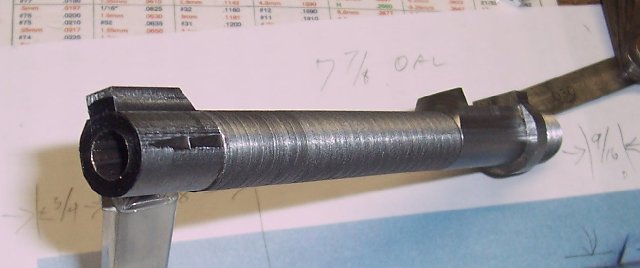

Still whittling down the excess metal...

I got some more done today, along with finishing my taxes...As per popular request, here's more pics...
First pic is cutting the rear sight dovetail; second pic is cutting the front sight dovetail; third is rough cutting the 9mm Parabellum chamber (I use Clymer finish chambering reamer w/high Sulphur content cutting oil; feed in 1/32" at a time, back out & blow chips away)...

The rear sight base has been contoured at rear; rear sight base is ~1/10" longer than Luger because I'll be using a shortened Mauser C96 tangent rear sight. Front sight dovetail is 5/16"; smallest I could find, which means my front sight will be fabricated in place. Muzzle and breech have been turned down slightly. Breech (where thread is) is still about 1/8" longer than needed, and thread diameter is still a bit oversize. Chamber will be cut deeper and headspace reamed in when breech is cut to length and barrel is fit to receiver.
I'll start on the front sight blank and rear sight base next.
