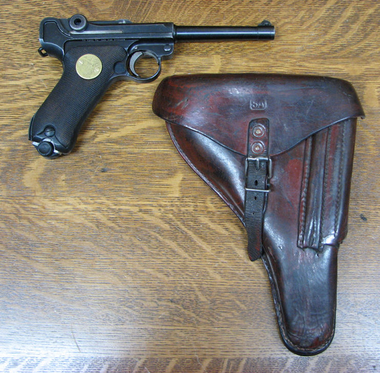

There is one ending on ebay soon, from whom I got my disc;
Here is my finn luger, 5 inch holster...

Nice piece of quarter sawn oak as well!
