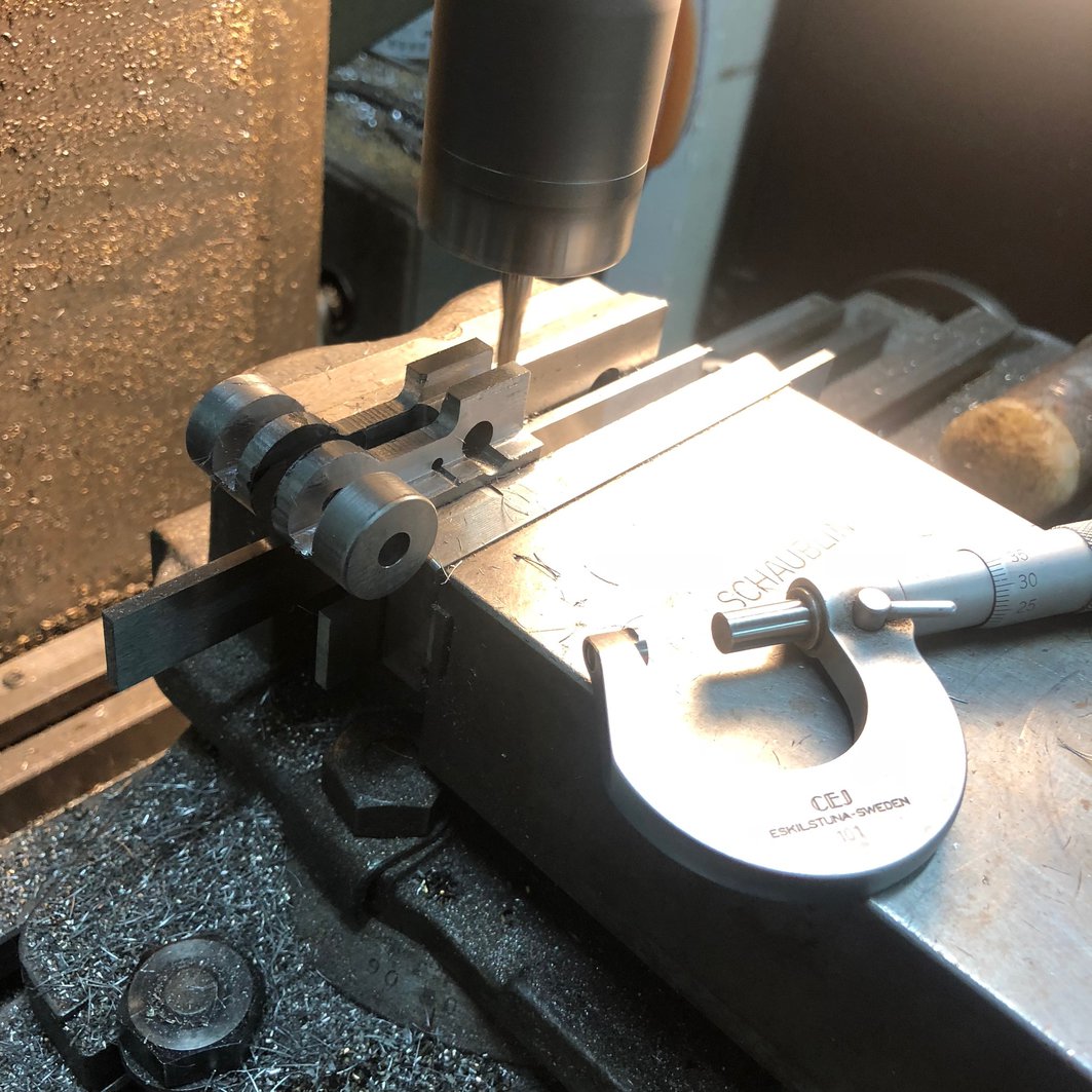

Next step is the making of a rear toggle with integral vindage adjustable rear sight.
Material is Swedish Uddeholm Calmax toolsteel That is really good against shock.

Here is the making of the sightsblade. All made in manual machinery and files.
