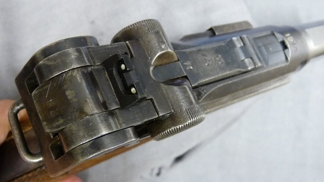

a 5" bull barrel of "GT" design works quite well and has a great balance; it is slightly reduced from the round profile by flats on the top and sides.
Here are a couple picture of mine; I also added an adjustable(windage) rear sight.

Dons rear sight is interesting and nicely done! I'm trying to go that route as well, but too many irons in the fire... ... Thanks to all for your support! til....lat'r....GT ......

Improved rear sights on the toggle as you know take a beating. Adjustable sights here are mainly(for the very few that do them) modifications of existing sights available. FWIW, I have found over the years that if I got rid of the elevation characteristic of the rear adjustable sight, that durability went up. A lot of homebrew fixed sights attached in various ways, or specialized milling or made up sub-bases for something like the S&W rear or the old Bomar sights appear here from time to time.
