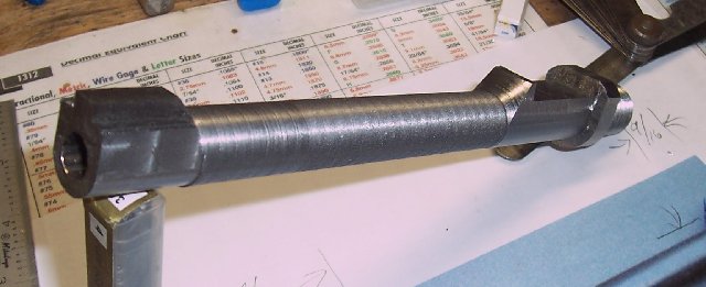

Still whittling down the excess metal...

Not an easy task, the artillery barrel. Enjoying the pictures.
Yeah, picture shows are fun! I'll be putting these on the CNCGuns site as a sort of How To...
Rich, what kind of lathe and other metal working machines do you have?
I had to sell all my real tools (Bridgeport, South Bend, Miller)...This is one of those Chinese 3in1 machines (and a rotary indexing head)...
Cut the lower radius's [radii???] today...
