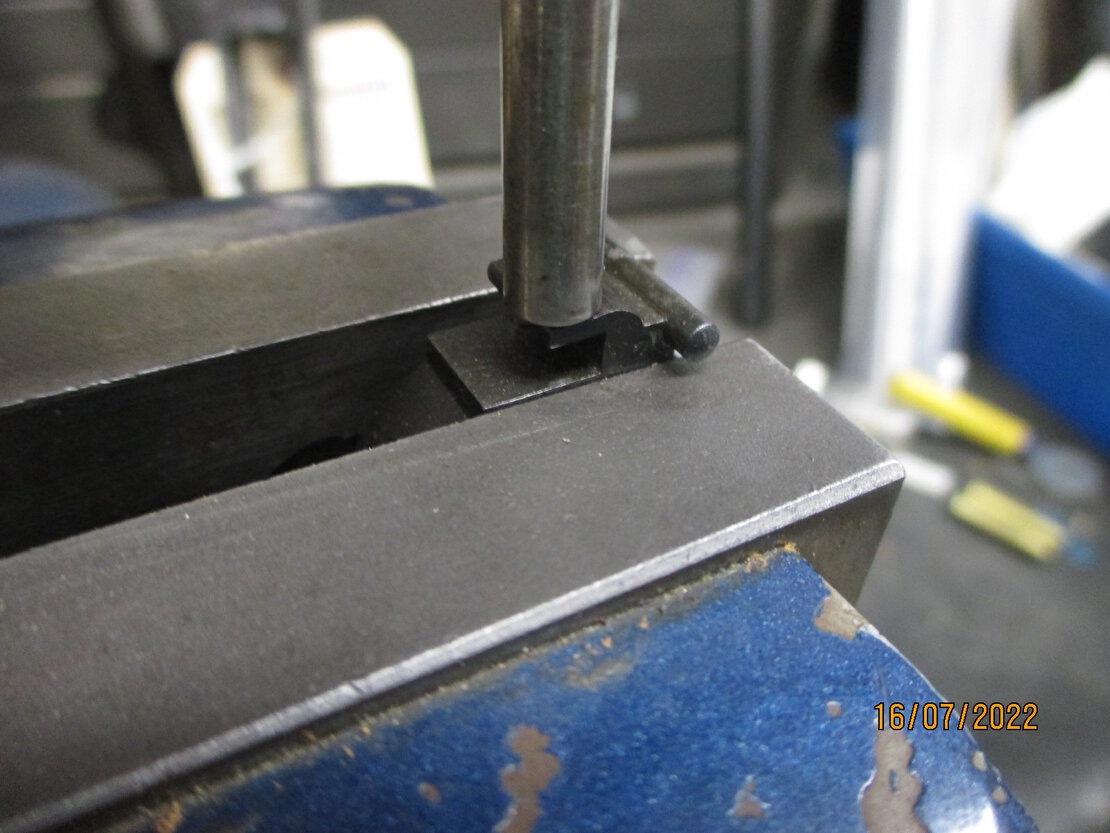

I've ended up with a couple of Lugers that had the same issue. After some examination and thought, I removed the trigger, and clamped it in a vise, and gently drove the top of the trigger notch down slightly, so it would engage the trigger bar sooner. Worked great, and no extra material needed. Go gently, a little goes a long way.
https://forum.lugerforum.com/attachm...1&d=1658018091
I've also done that a time or two but not knowing the OP's skill level I decided not to mention it. It does work great and, I suspect, is how a unit armorer may have corrected the problem. The JB Weld solution is safer but either will work.
Good idea- but, I did that same trick once;
the upper arm snapped right off !
Just be aware, do you feel "luck today" .
I was talking about the trigger, not the trigger lever. I would never think about trying to bend the lever, although I seem to remember seeing a Swiss made tool/jig for doing that in a controlled manner. The trigger shelf seems to be soft/not hardened from my experience.
