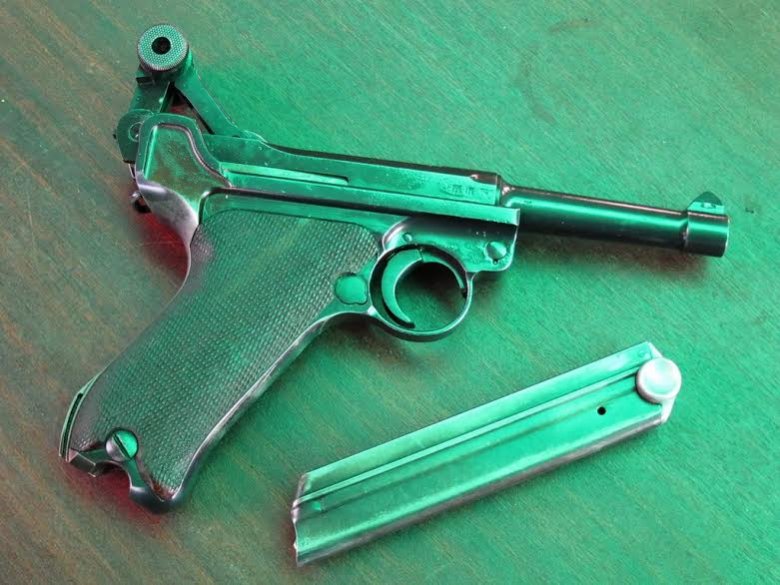

I posted some photos below
Best
Mario
S42 Photo Click Here
S42 Claw Click Here
S42 Seat Click Here
S42 Main Spring Click Here

Don't know if anyone has mentioned it, but hold the gun very firmly when you shoot it. A loose grip can be the cause of function problems.
Unread 05-08-2016, 09:17 AM   #14
Can you show a photo of the other side of the pistol as well?
If the tip of the ejector spring (flat leaf spring on the right) is broken off, you will get the same result. The spring must have a triangular extension which contacts the front of the toggle (you will see that the front of the toggle 'bolt' has a linear groove in which the ejector spring 'rides'.
In Vlim's line of thinking I would also like to see a picture of your pistol taken just like this one:
Also would like to see another picture of the feed ramp but this time taken after cleaning.

Tx Vlim, and all
here is one I have, I will do like above with toggle up shortly.
Right Side with mag IN Click here

Originally Posted by mario17 View Post
Tx Vlim, and all
Well, it seems you will need a new ejector.
With the action closed the ejector should be flush flat with the frame and not bent inward.
Unread 05-08-2016, 03:38 PM   #18

Tx kurusu, I got an idea,
I'll check one more time this flush end when home, and if its moving along toggle, not sure about pic, hard to see.
Will update asap.
If it's case we talking about ejector spring or whole ejector replace?

The ejector is one piece, it is itself the spring and has the right angle protrusion that strikes the cartridge.

The most probable reason for the ejector being inwards with a close action is a broken tip in the breech end.
There are a few pictures in my next posts.
