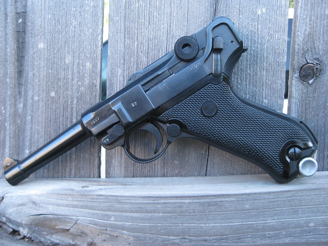

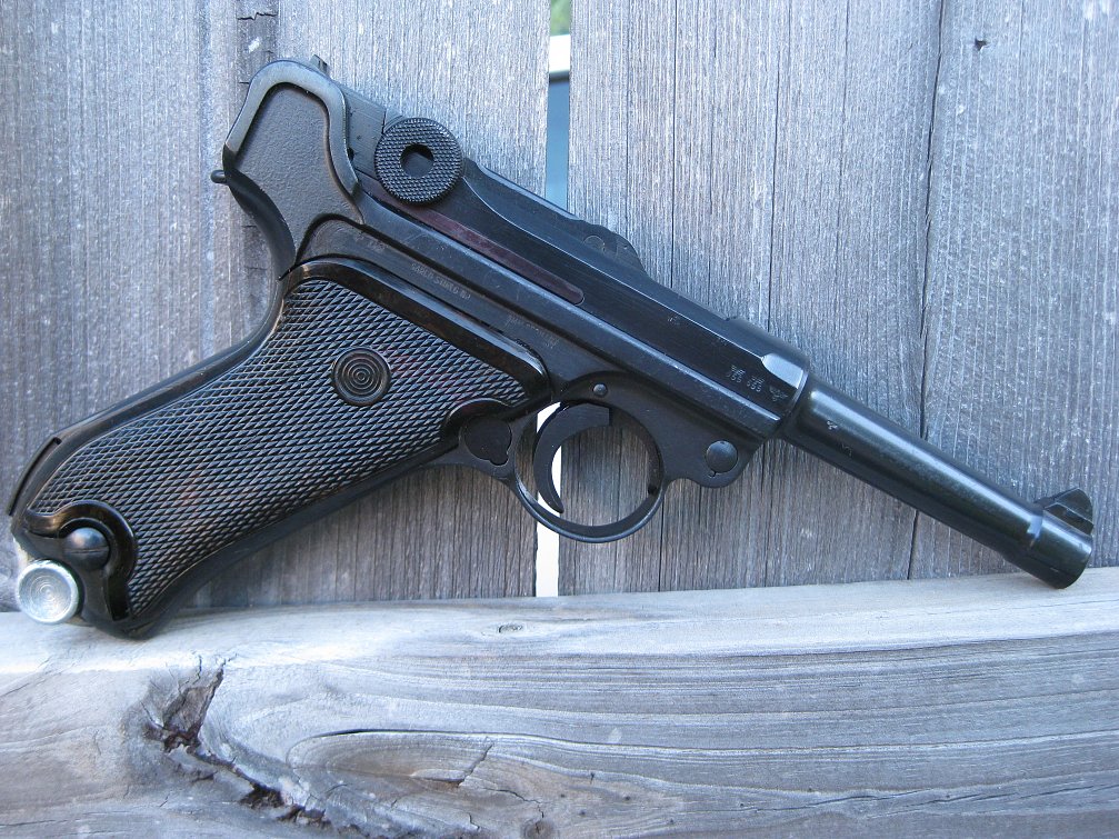

Thanx to Mr. Tinker, I now have a new set of grips:
Brand new, wood based "stag" grips. I actually think I like them - they're MUCH fatter in the hand than the regular style. My wife and I are headed for the range tomorrow, I'll see how I like shooting with them - my wife may like them better too. I need to test out my latest G.T. sourced and fxo sprung triple-kay mag as well.
Thank you Edward!!
