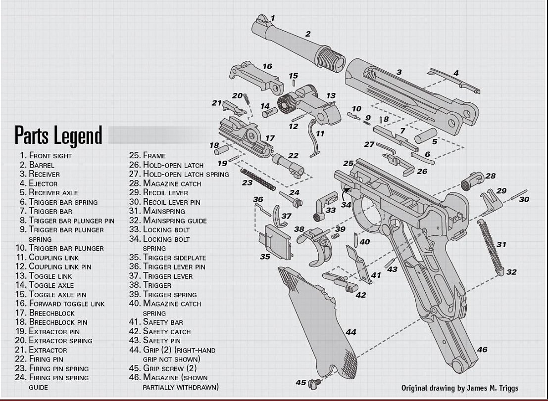

lugerholsterrepair, ejector looks good I think, not chipped or broken (see photos previous page). What are "extractor lips"? What number would you assign them on the parts legend below?
