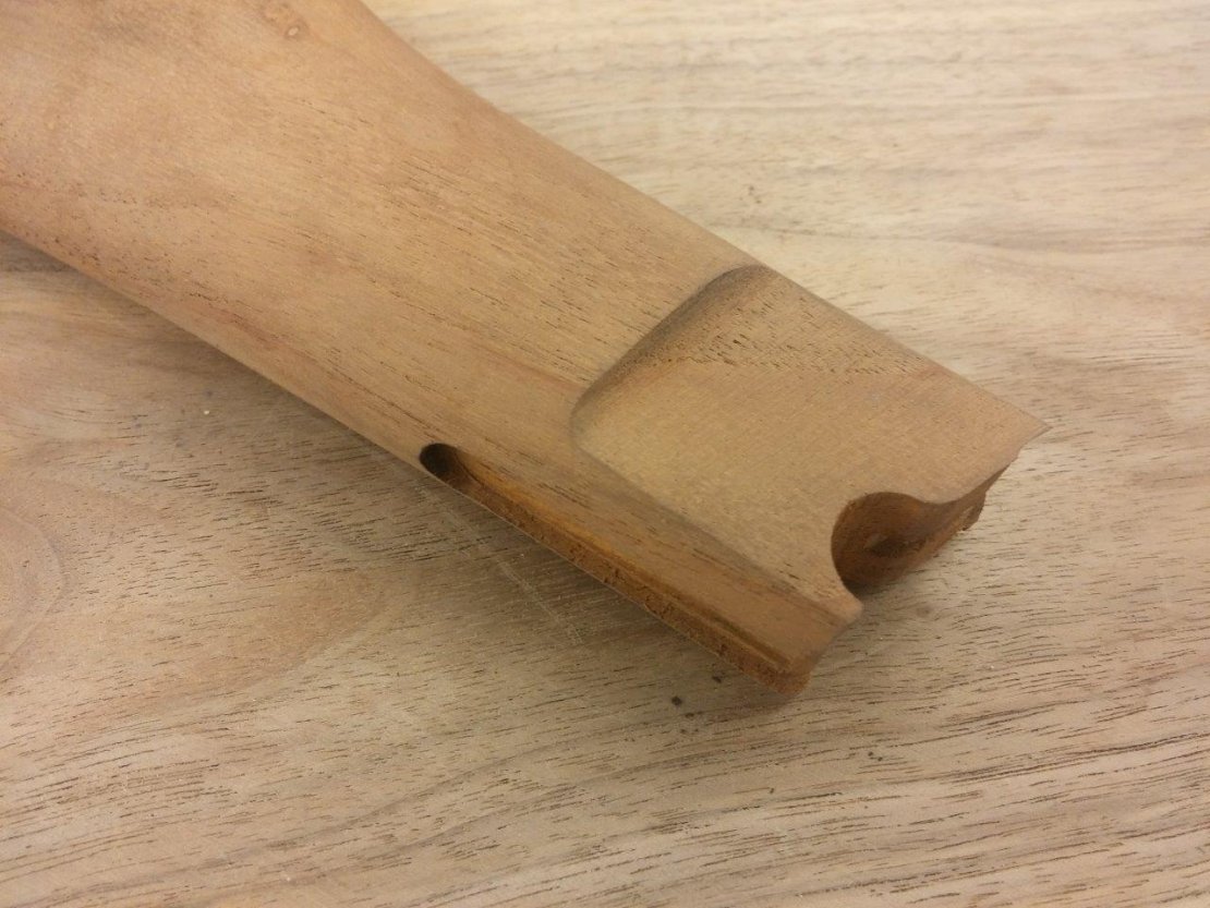

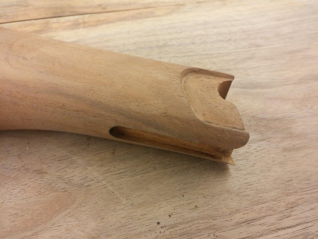

Unread 11-01-2014, 05:59 PM   #9
Yes, I have a question...What happened to Ed Tinker's carbine???
Well I asked him, fairly abruptly, as I am a bit impatient nowadays. I am 54, I could die any day
He sent me these stock pictures, but I could have sworn it already had a stock...
Edward Tinker is offline

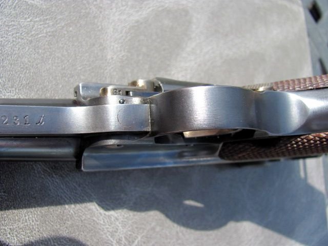

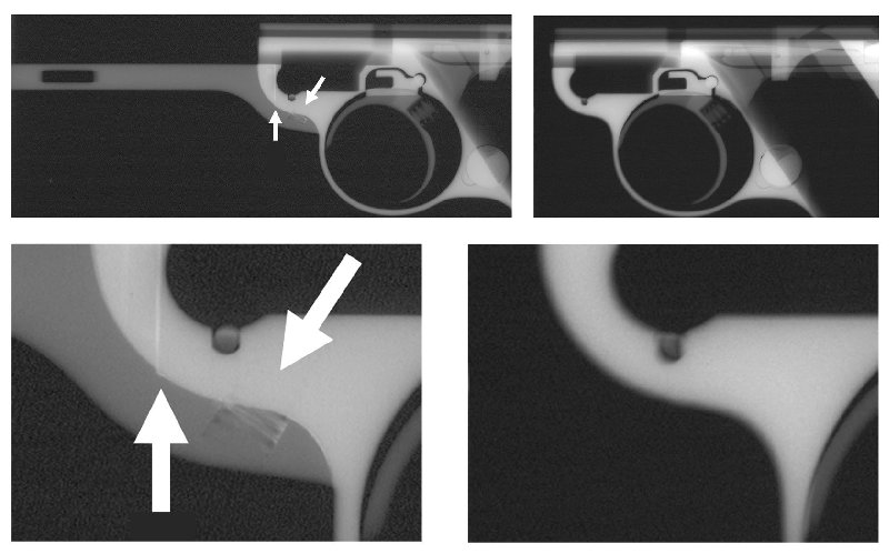

Unread 12-11-2014, 09:55 PM   #10
Originally Posted by LugerMan.com View Post
Hook is attached by silver alloy and is the way the original carbines have been done, George Luger trusted silver , who am I to question that ;0)
Actually the forearm lug was attached by a screw prior to silver brazing. Sturgess & Gortz have a nice X-ray pic of the frame showing the screw on a carbine compared to a 'regular' frame (pic below).
I had noticed a ground-off screw in the pic of Eric's carbine also (other pic).
I hope this doesn't mean you'll have to start all over...
sheepherder is offline

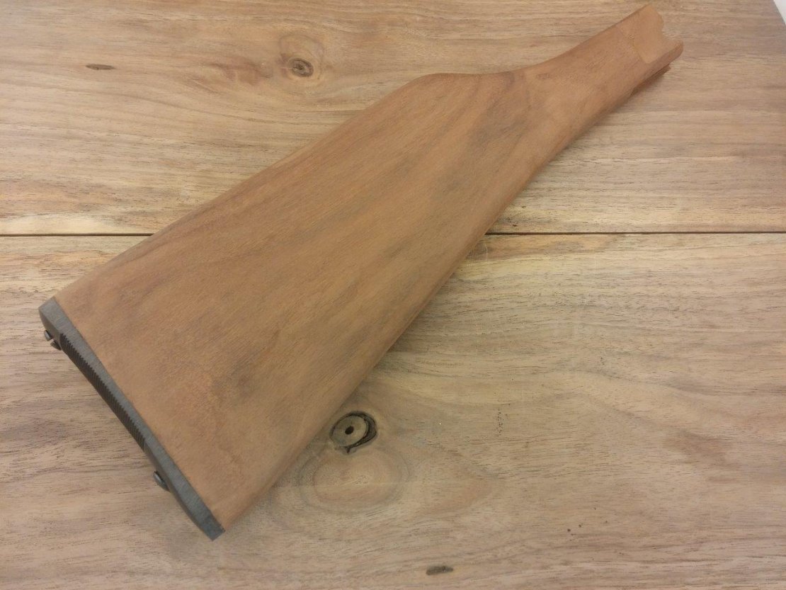

Unread 11-09-2013, 03:04 PM   #15
Excellent!!!
I love watching a piece of art evolve!!!
Interesting that the rear sight base on this carbine is of the 'split' type...
I don't recognize the wood, but it reminds me of a story I heard at the last gun club meeting...There is a small Amish community nearby, and they offered to clear some local land of trees...The trees were 'black walnut'...An Amish work crew spent a weekend felling and cutting up the trees and hauling the wood away...We assume they plan on making furniture from the lumber...
Unread 11-09-2013, 03:18 PM   #16
yikes, I recognize that gun - cool
Eugene you keep adding and I'll make a sticky (unless I am too prejudiced, then folks just tell me).
Rich, lots of guys who fell trees or cut up the ones from storms harvest the wood, I am ok with that. We have tree cutters coming out this monday for my neighbors and some of our big branches, I am tempted to ask the logs be cut into reasonable pieces and I would finish up the rest for next years firewood (no oak or the like)
