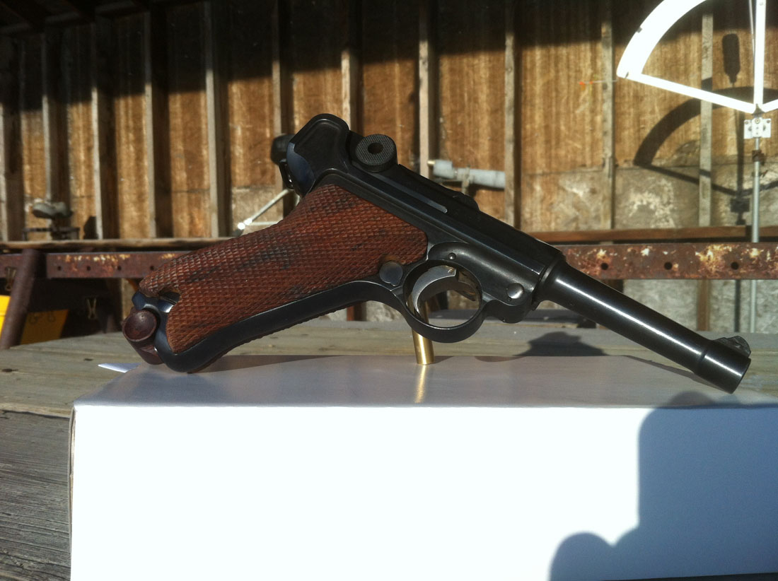

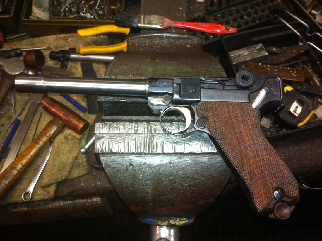

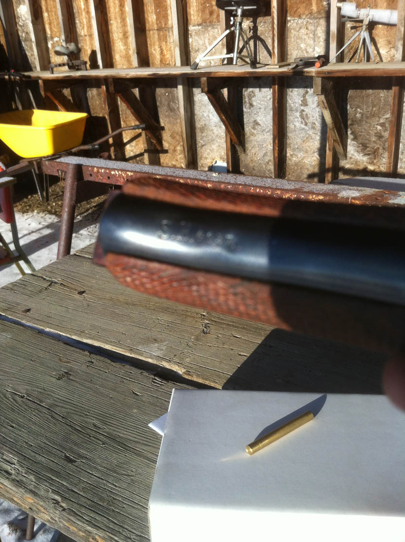

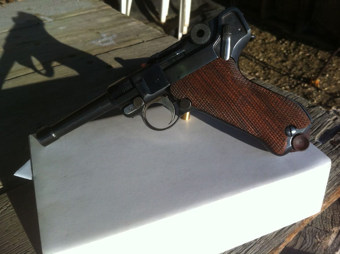

Well, finally received, and got around to re-barelling my pistol. She started off as what i beleive to be a 20's era commercial. The serial number on the frame is 7881 with a little stylized L underneath it. It also has some military stampings on the front of the grip. Unfortunately I don't recall what they are, and the pistol is with a friend for legal reasons. It's in overall excellent condition, re-blued by someone competent at some point, and in overall matching condition. A few parts are mismatched, but nothig major and nothing exterior. Here are a few before and afters:

It looks good. How does it function, or have you had time to really give it a go?

Well, I am having some issues. The gun functions perfectly, however is out f sync and will not cycle. The upper receiver travels all the way bak and unlocks the toggle, but the bullet and pressure have since left the barrel, and no pressure remains to force the case back and operate the toggle. I'm going to try a lighter mainspring, which will hopefully help, but if it doesn't I will have to lighten the barrel until she functions.
