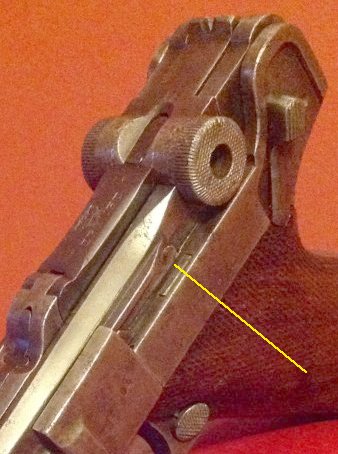

I notice something on your Erfurt which I have never seen on a Luger before - it is a round object/feature at the end of the sear bar where it meets the spring (yellow line points to it in pic below)...Can you tell what it is???

It looks like a round pin but it's not....just light effect....check out the pic from a different angle...

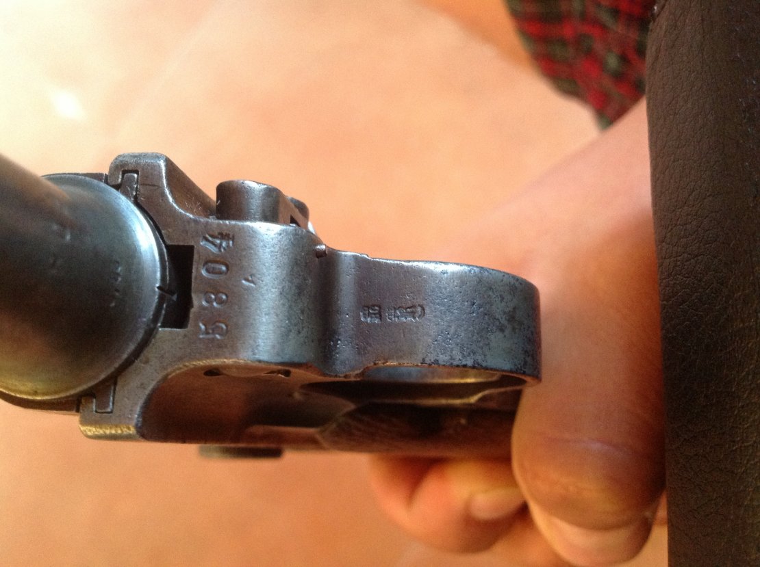

Overall good conditions, a bit on the rough side, right grip a bit woobly and there are traces of rust....I have checked all markings and stamps...seems all period, but I have also noticed an arsenal proof front of trigger guard....wondering if modifications or repairs have occured with this piece...

...and the pic that solves the mystery on the round pin...
