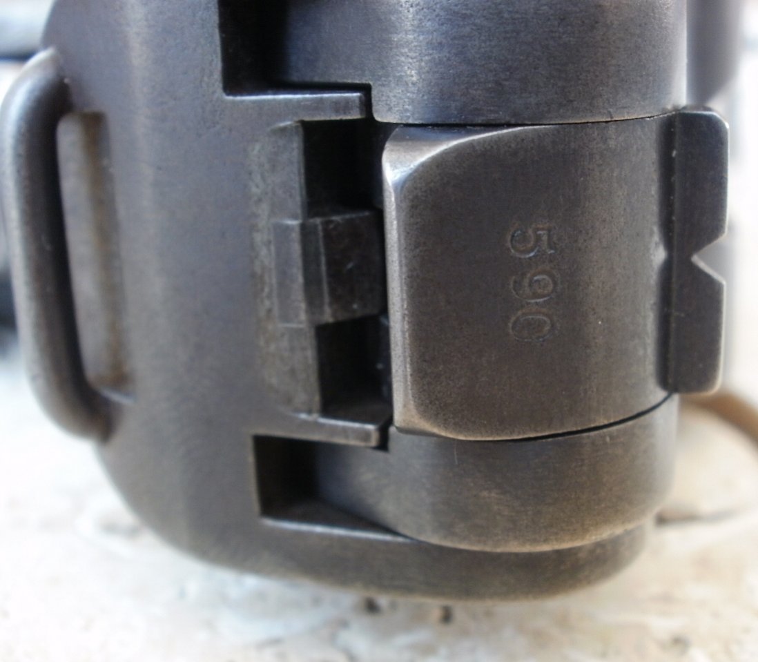

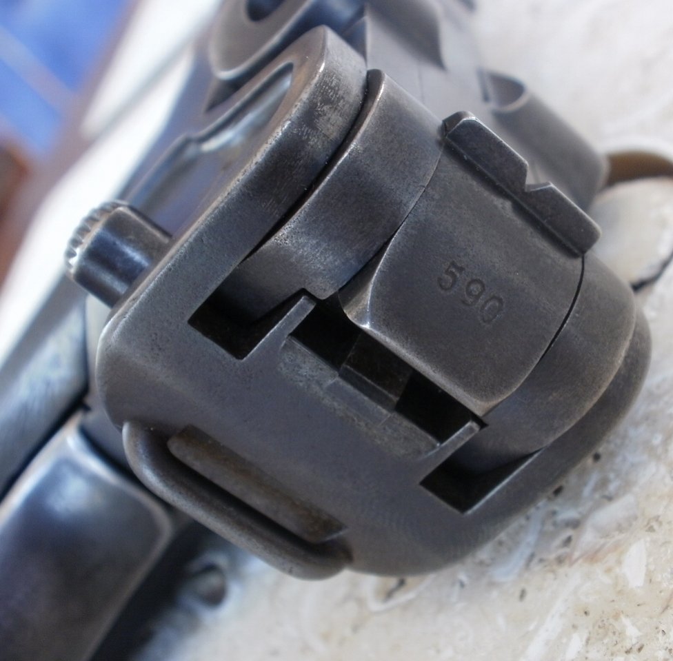

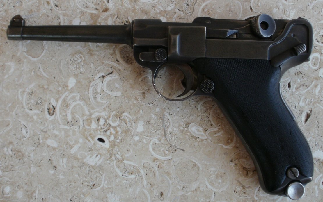

Just received Old Model S/N 17590. Finish is gone, mainspring has been substituted for a blacksmith's fabrication and firing pin, also a blacksmith's fabrication, is broken. All numbers matching including grips, which are very thinned with no checkering left (although its remnants can still be seen) and have been tinted black.
Other than this, the pistol is in great shape. I would appreciate your opinions. I would also appreciate your recomendations on (i) whether I could/should restore the grips (with an expert you could recommend) or try to find original used grips to substitute the originals, (ii) should I reblue?, (iii) what is the correct original thickness of the mainspring blades, (iv) can an original mainspring be found?, (v) can an original firing pin be found? and (vi) can an original used magazine with unmarked wooden bottom be found? I have already written to Mr. Heller for help.

Pretty nice gun. I have an original mainspring for $100 unless you can find a better deal. Send me a private message if you are interested. Hugh Clark can work miracles with your grips. Probably should hold off on refinishing the gun...it looks fairly appropriate for its age and I doubt that a restoration would increase its value all that much. I bet Tom Heller will come up with an appropriate magazine...it should have a wooden base without any markings. Good luck.

Nice gun. You might also want to replace the missing Toggle Latch Catch

If you look at photograph number eight that you posted, (full right side view of the gun), look just below the knurled, dished toggle handle. The toggle handle has a spring loaded latch, which should hook into a corresponding catch in the frame. That empty slot in your frame just below the toggle latch once held this catch. Yours is missing and needs to be replaced in order for the gun to be correct and complete.

Well, the people said everything on the previous postos: get a new pair of grips (or have them sent to Hugh Clark), a correct magazine (wood bottom) and Ron's mainspring and DO NOT REFINISHED the gun. Its finish turned into an attractive (at least to me) gray patina, and any work on it won't improve its value. You'll see that it will lokks fine with the new/refurbished grips and new mag.

Restraw it and then antique the new straw back to about 40%. It will look right at that level. The grips can be recheckered.
Unread 04-28-2012, 09:11 AM   #15
No.. the straw and grip match the overall condition well. "Enhance" them would make this one unbalanced. Unless redo everything, it's better just replacing broken & missing parts to make it serviceable. The wrong left panel screw and magazine bottom are less important from functional point of view, probably can be left alone.
