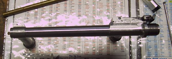

Unread 02-12-2009, 03:55 PM   #5
Still whittling down the excess metal...

Unread 02-12-2009, 07:07 PM   #6
Not an easy task, the artillery barrel. Enjoying the pictures.
Yeah, picture shows are fun! I'll be putting these on the CNCGuns site as a sort of How To...

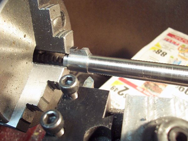

I am very interested in how you intend to cut the remainder of the front barrel band... and then then merge it with the small end of the barrel taper... take plenty of photos please including the actual cutting operation...
Kind of hard to do...while cutting...oily hands, concentration, paranoia...
But I shortened the front sight base a little; cut back the front of the rear sight base; turned the threaded portion back to specs & finish reamed the chamber; and finally cut the taper...The taper came out very good...

I got some more done today, along with finishing my taxes...As per popular request, here's more pics...
First pic is cutting the rear sight dovetail; second pic is cutting the front sight dovetail; third is rough cutting the 9mm Parabellum chamber (I use Clymer finish chambering reamer w/high Sulphur content cutting oil; feed in 1/32" at a time, back out & blow chips away)...
