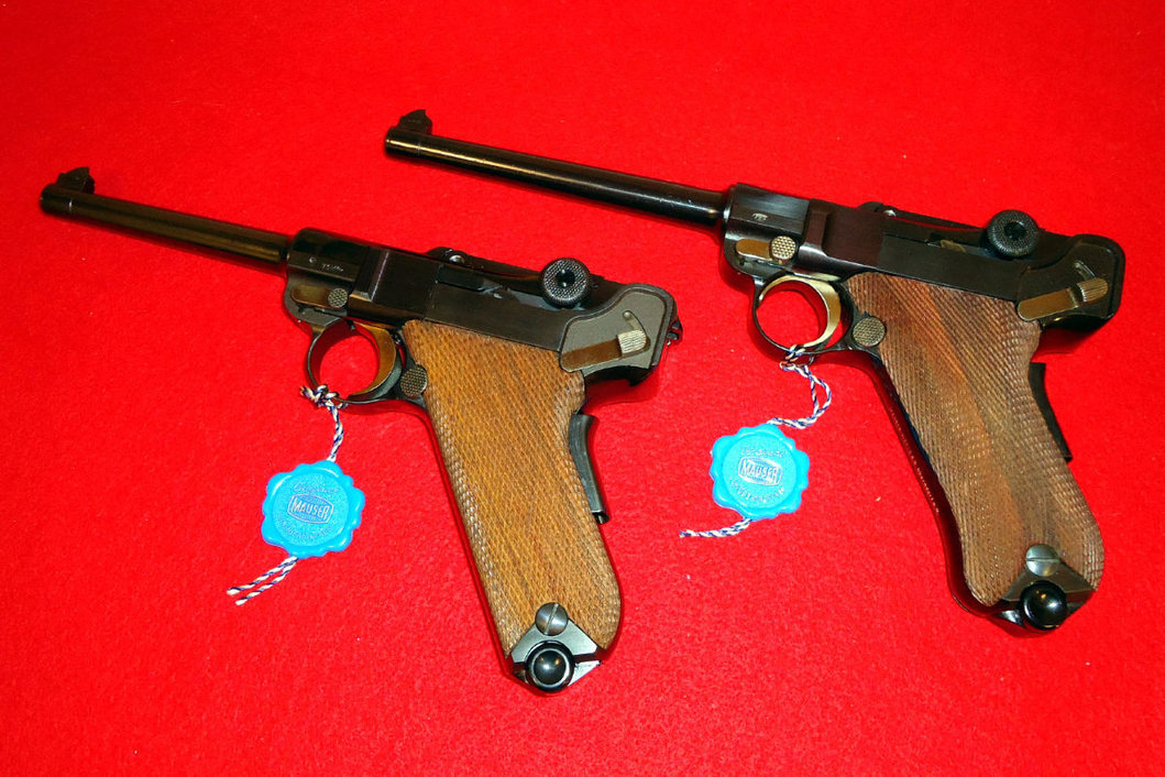

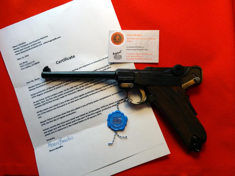

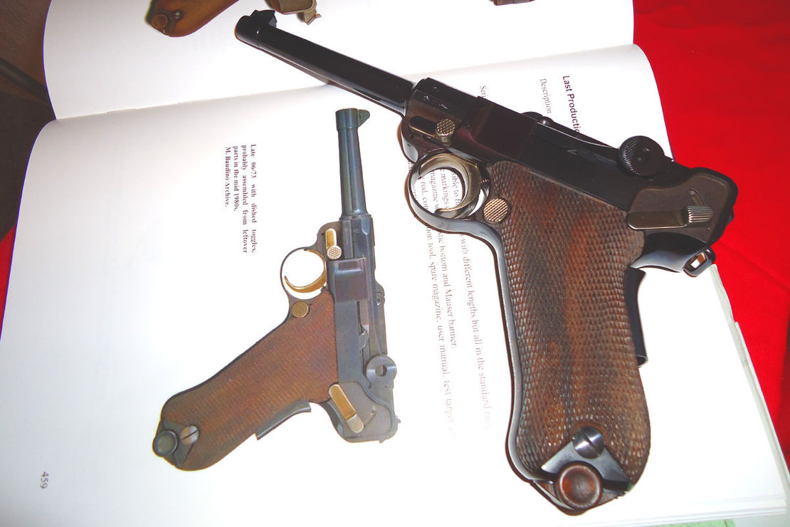

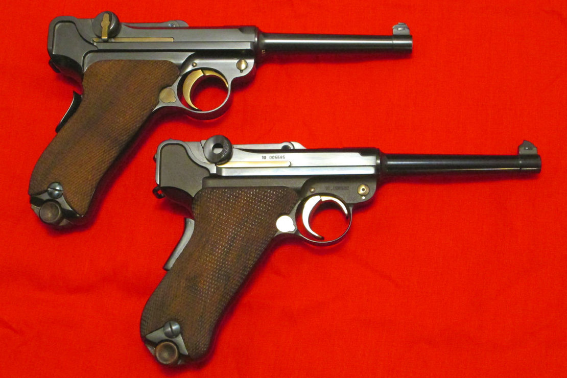

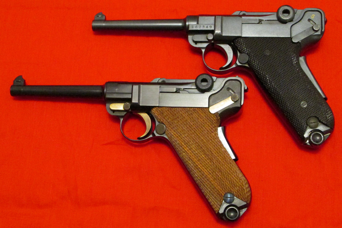

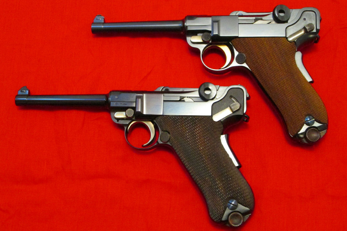

Here's a few quick photos of Mauser Parabellum pistols with the scarce 5 inch (12 CM) barrel length.
Photo 01 shows the sure fire way to identify the 5" barrel variation-it doesn't fit the styrofoam box! Notice the crude chunk torn out between the 4" and 6" front sight locations. Photo 02 shows this pistol next to a Model 29. I would say this pistol-10 004558-is as close as Mauser ever came to duplicating the M29. Photo 03-moving up 50 numbers to 10 004618-is the same type except with P08 style safety. Shown next to regular 6" length 06/73. Photo 04 shows a 5" "Last Production" variation made in 1985 on it's related page (459) in "The Parabellum is Back", our must-have reference book. Photo 05 shows this pistol with a 1900 AE. I could call this a "First and Last" Luger photo-spanning from @1902 to 1985. Kind of ironic the "Last Production" Luger harps back to the first model with the 1900 style dished toggle. Photo 06 is just the other side of these two pistols. Hope you enjoy these, best wishes, Joe 01 10 004558.jpg 02 10 004558 and 06 29.jpg 03 10 004618 and 10 005505.jpg 04 10 005585 page 459.jpg 05 10 0055858 w 00 AE.jpg 06 10 0055858 w 00 AE.jpg Last edited by Joe in Colorado; 07-11-2020 at 11:09 PM. Reason: spelling correction |

Thank you all for the great info!
Mauro-yes, we need to talk-do you have dates on all 3 of these 5" pistols: 10 004558, 10 004618, 10 005585? Vlim, did I understand you to say that some or all of the 5" barrels came from Switzerland? Barrels placed on pistols with Swiss frames like 4558 and 4618 above? I will start a new thread with more details on the 5" "Last Production", including the 1986 sales receipt from Waffen Walla and the business card of the Mauser Marketing Manager for domestic sales at the time. Cheers, Joe |

I'll attach a photo of the first certificate you made for me-for number 10 001075-one of the very first production pistols. (For those who haven't heard, production started at 10 001001.) Pistol 1075 and 5585 above could serve as close to "First and Last" bookends for @20,000 regular production Mauser Parabellums-1970 to 1985. One last question-do you also have info on 5" pistol 10 004515? Finally-if anyone has a green Mauser hang tag to sell or trade please let know. (I need one for 5585.) Cheers, Joe |

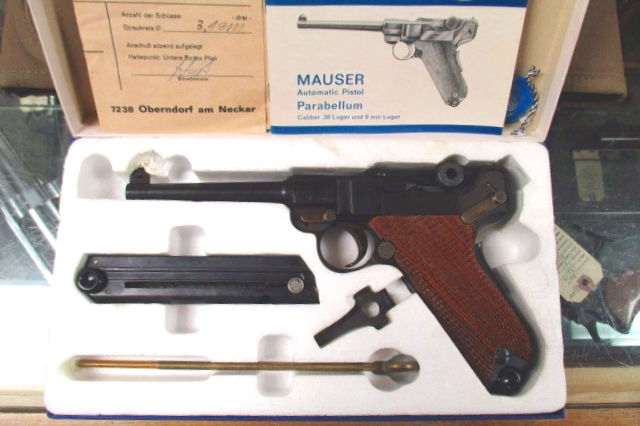

Thank you again, Mauro.

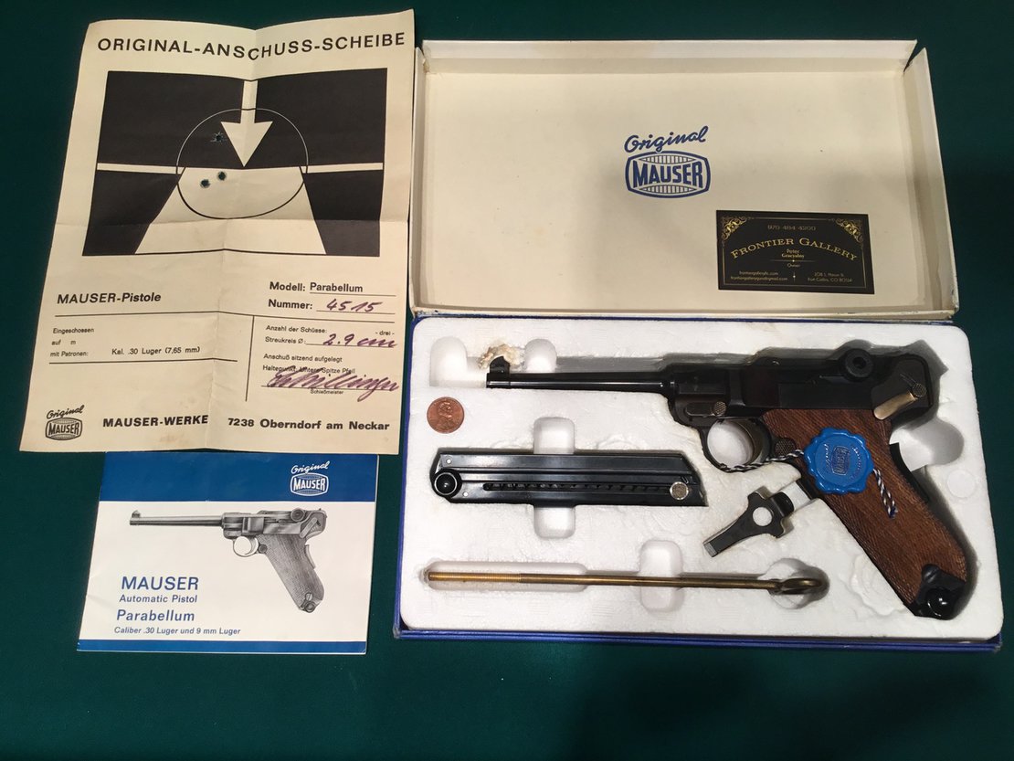

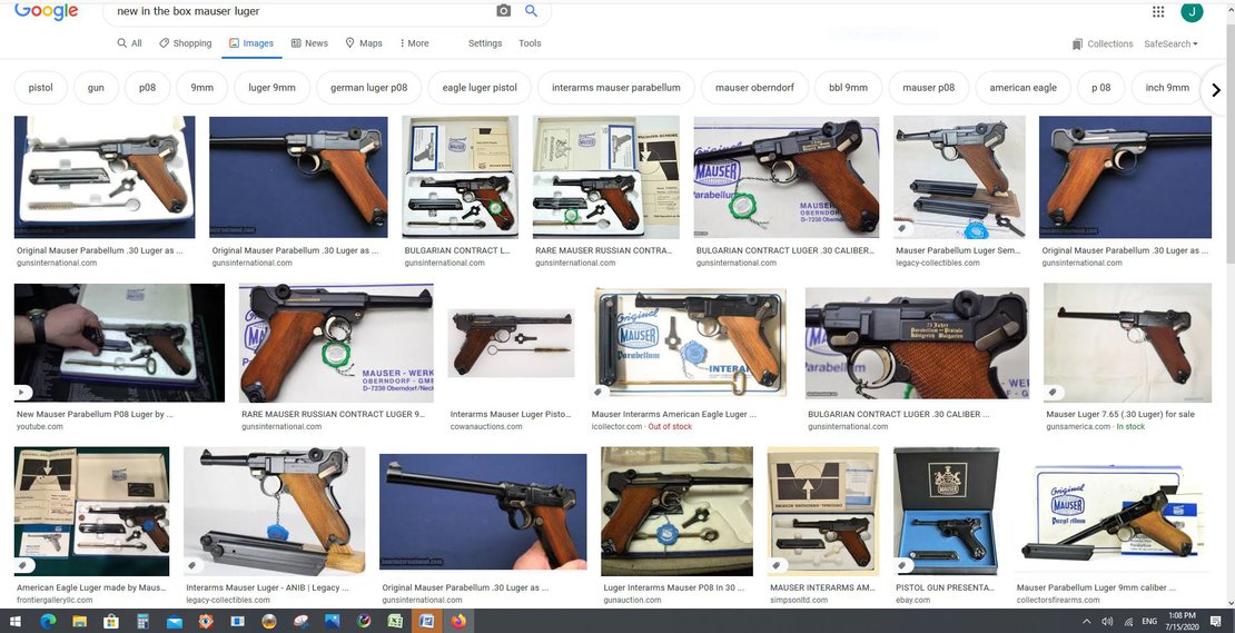

Here's why I asked about 10 004515: after I started this post a few days ago I did a Google image search or two-looking for evidence of more regular production .30 pistols with the scarce 5" barrel. (I had done similar search months earlier looking for another nickel plated Mauser Parabellum (image 00) with zero results.) Image 01 is a screen shot of one page from the search results-row one shows a 5" but its a commemorative. I saw, in the bottom left corner, what looked liked another regular production 5". It was linked to Frontier Gallery LLC, a well known dealer in Colorado and a regular at the annual Colorado Gun Collector's Show (cancelled this year due to coronavirus). Frontier Gallery moved from Denver to my hometown of Fort Collins a few years ago---what a coincidence---that I found another one of these ultra-rare pistols-still for sale-right in my hometown of all places!!! Due to coronavirus panic buying it took over 2 days to clear the background check, but I took 4515 home last night. The pistol has really nice wood grain on the grips and could hardly be in more pristine condition. (Image 02) By chance if anyone has what Vlim said is the more common 06/73 with a 5" barrel to spare and wants one with a Swiss frame perhaps we could do a trade. Best wishes to all, Joe |
