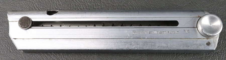

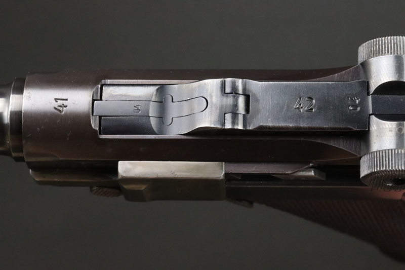

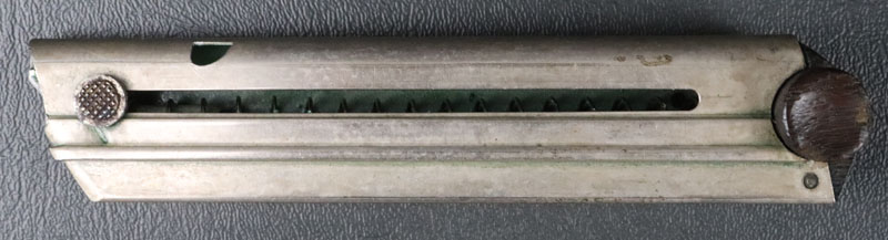

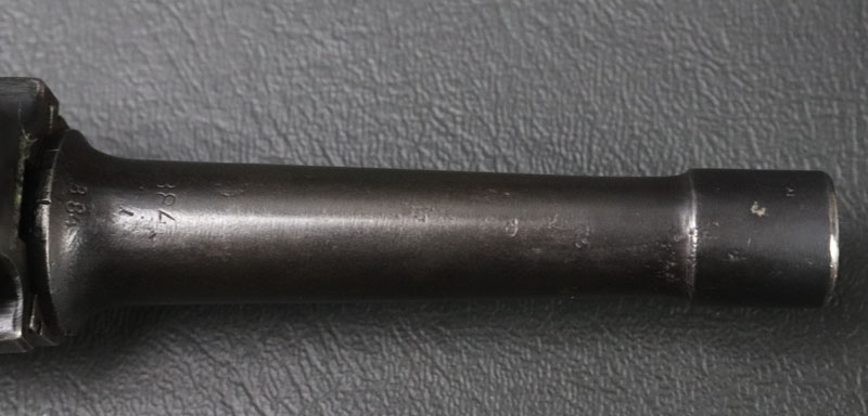

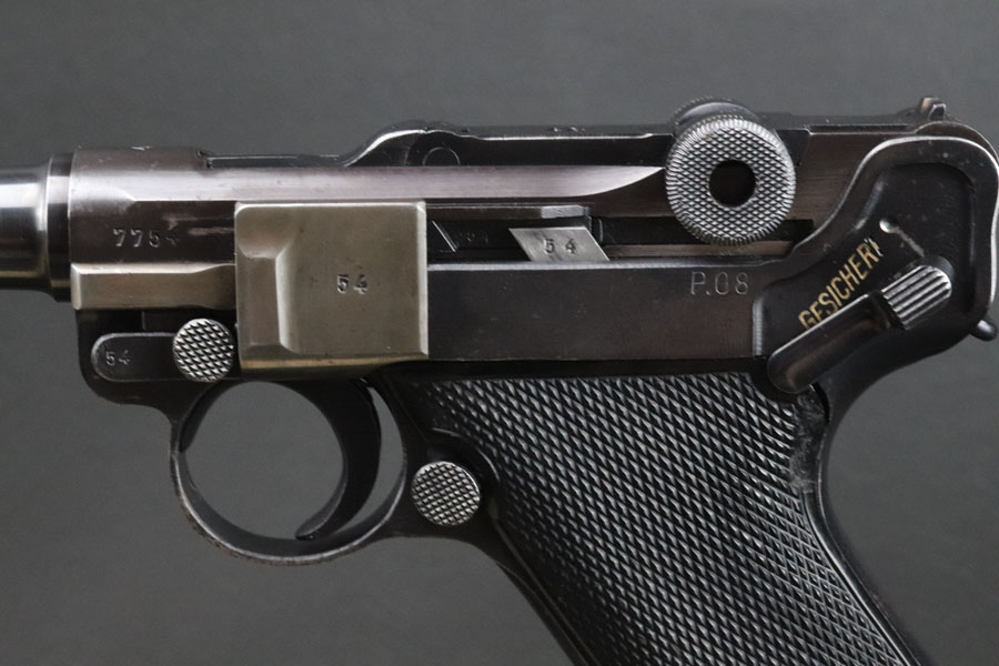

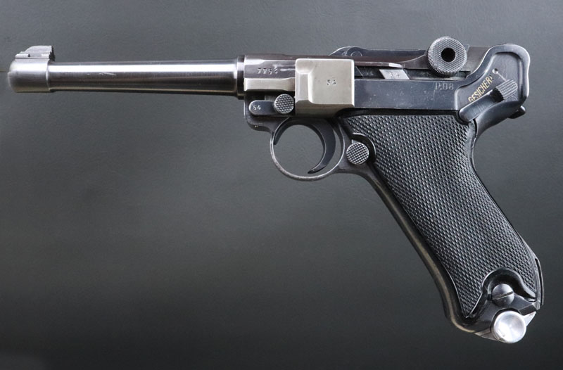

Avid gun collector but don't know anything about Lugers. Can someone tell me what I have? Also there is a number on top 41 and 42, are the parts mismatched? Thanks

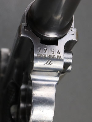

Yes, your parts are mismatched. the Toggle train seems to have 04 whereas the rest of the gun's parts end in 54. The barrel does not look original, and I am not sure about the "GPGI HBG PA" stamp between the serial number and its suffix.
Looks like it will make a nice shooter, I am sure more people will chime in soon.

The 41 on the chamber indicates manufacture in 1941. It was made by Mauser. The mismatched toggle train bears the Mauser code 42 and is not a date.
The barrel is a replacement and the front sight has been filed down. Although numbered to the gun, the side plate lacks finish and may be a replacement.
The stamp between the frame serial number and suffix letter is the importer's mark.
It's a shooter and not a collectible but if it shoots as well as it looks, it should be a good one. It's also a military pistol, not commercial.

I'd wager it's a Canadian import and the barrel may be a .30 calibre.

Ed, I have a BRNO #4 rifle that was imported by KBI Inc. HBG PA. It was sold through National Sports Dist. in Southampton, PA. When I had my FFL, I sold a lot of BRNO rifles that I bought from them. That was in 1993/94 mostly.

GPGI
7455 PAXTON ST UNIT 16
Harrisburg, PA 17111
Phone: (717) 554-9664
Also shown as GPG Imports. No web site I could find. Google results seem to show it as an LLC/dealer. FFL listings.

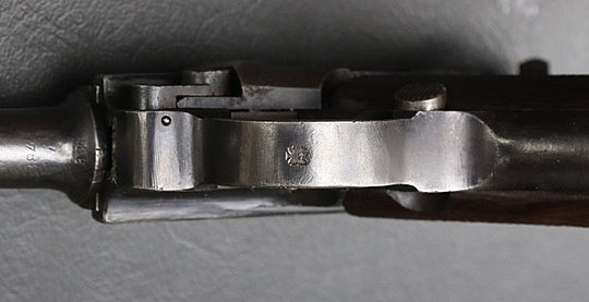

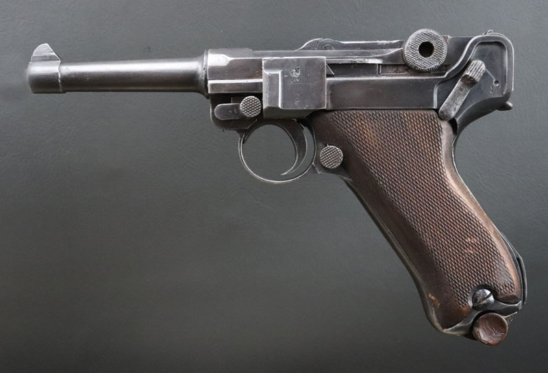

Default Here is the other P08
Thanks

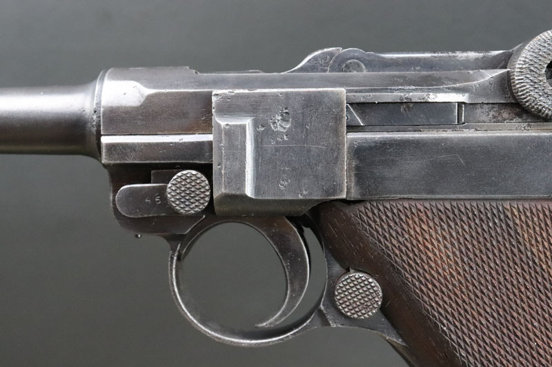

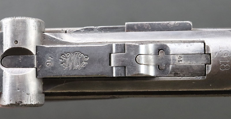

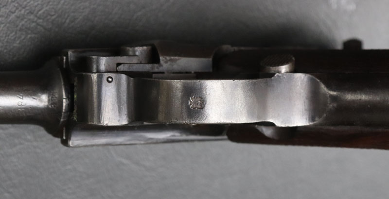

Standard military 1918 DWM that has been refinished. The side plate is a replacement as it's unnumbered. The grips have been modified.
The stamp on the trigger guard is unusual and appears to be, or may be, a Prussian Eagle. It is not the normal crown/letter stamp found on all Erfurt trigger guards so the frame is likely DWM.
