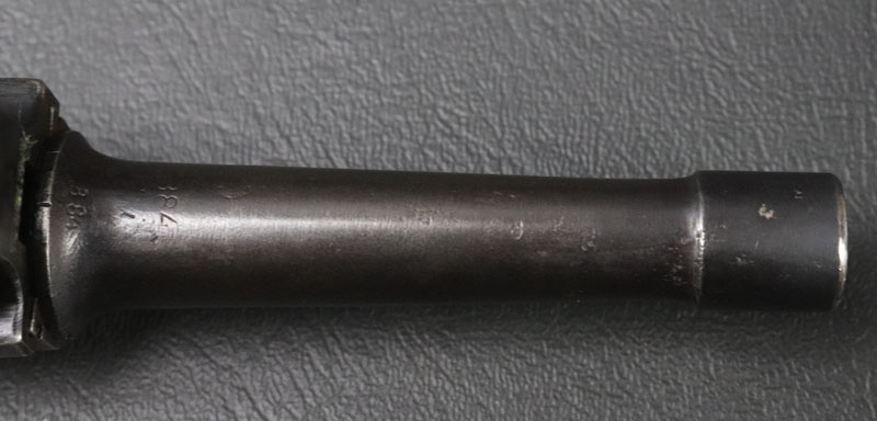

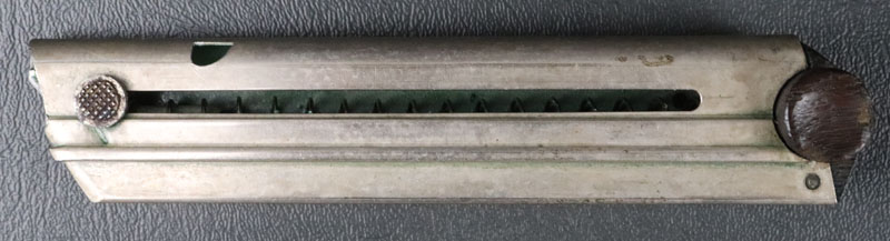

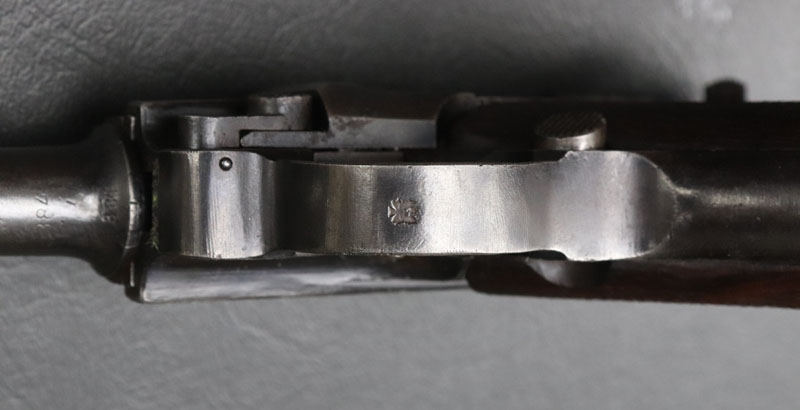

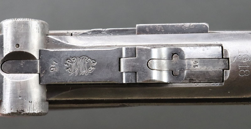

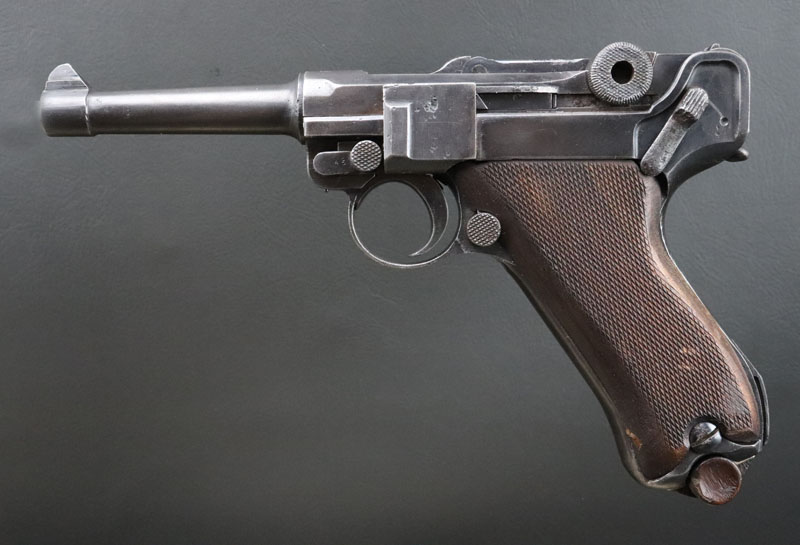

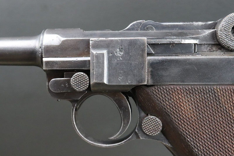

Here is the other P08
6 Attachment(s)
Attachment 80208
Attachment 80209
Attachment 80210
Attachment 80211
Attachment 80212
Attachment 80213
Thanks
Doubs 07-27-2020 05:38 PM
Standard military 1918 DWM that has been refinished. The side plate is a replacement as it's unnumbered. The grips have been modified.
The stamp on the trigger guard is unusual and appears to be, or may be, a Prussian Eagle. It is not the normal crown/letter stamp found on all Erfurt trigger guards so the frame is likely DWM.
