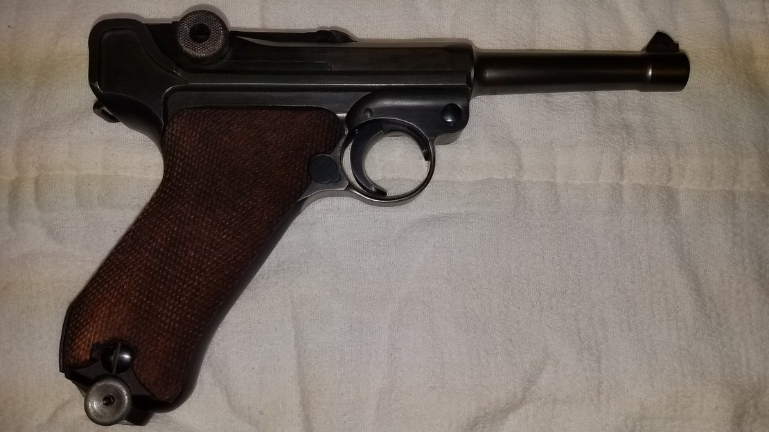

I have a 1936 S/42, all matching serial numbers, stick eagle on barrel. There are no other waffenamt markings on the right side. Why are there no markings? Does it make the luger less valuable/collectible? Has matching 1936 dated holster.

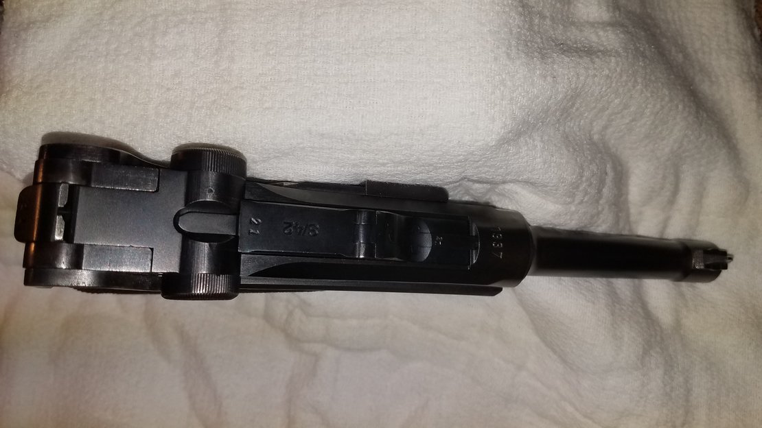

Looking for information as to why there are no waffenamt other than stick eagle on barrel. Due to their absence is value/collectability less? Has one matching magazine and holster.

Better pictures for a better answer, but if there are no markings, then it is highly likely they were removed during refinishing.
If they are missing, it would be worth less, IMO.

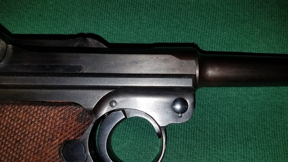

Default S/42 No Waffenamt
Tried lighten

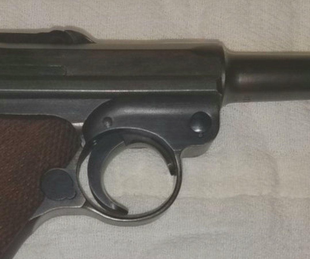

Unread 01-22-2020, 10:54 AM   #15
Lightened it a bit more.

Hope these help to make determination. Why is this considered worthless?

I think it might be a replacement receiver, old army gun smith repair. Finish looks good to me.

Unread 01-22-2020, 03:16 PM   #20
He did not say its worthless, but worth less, i.e. not as much as a proper WaA marked example.
