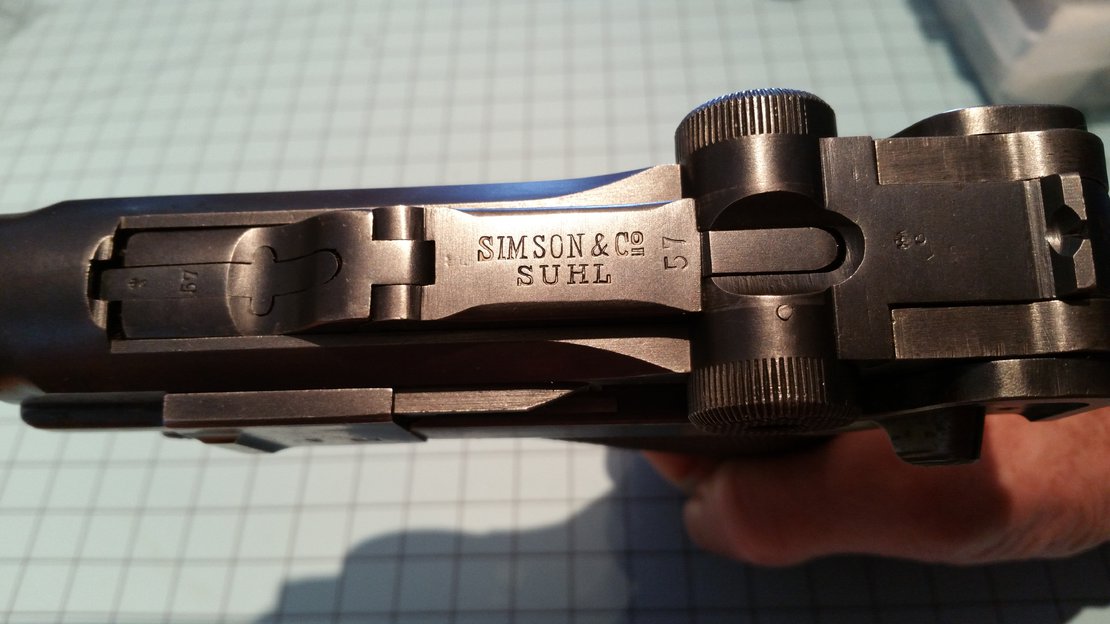

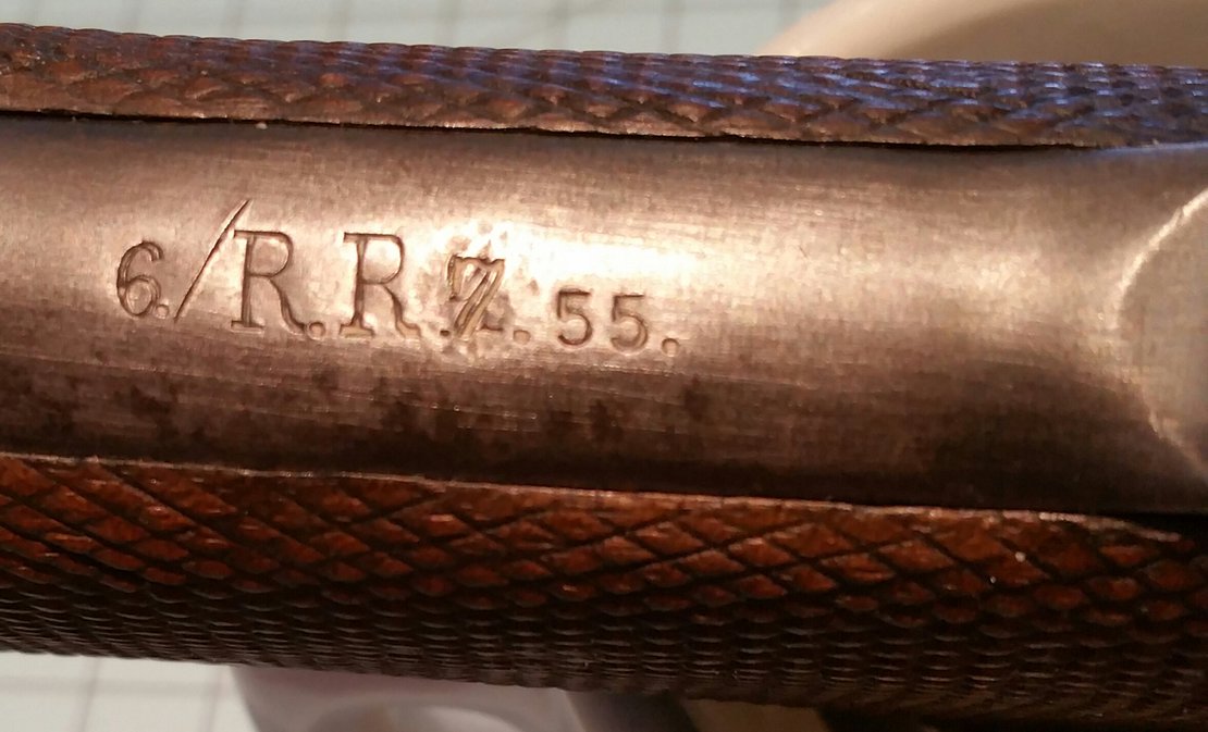

Simson pistol, I think this is Reiters Regiment is that right ? It looks as though the 7 is struck over a 4

I have these three in my records;
4/R.R.1.48
6./R.R.7.55.
R.96.11.5.
The straight R.R. instead of cursive for WW1 says Recruiting Depot Regiment.
So, not really sure...
Unread 07-03-2019, 04:22 PM   #3
Reichswehr marking:7th Reiter Regiment, 6th Squadron, weapon #55. A cavalry unit marking.
Unread 07-03-2019, 04:22 PM   #4
6th Scuadron Reiter Regiment (/ = Reichswehr)

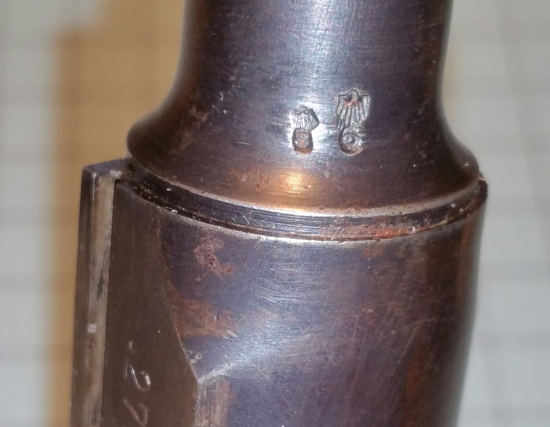

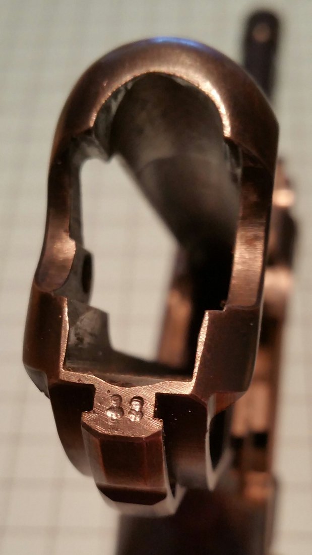

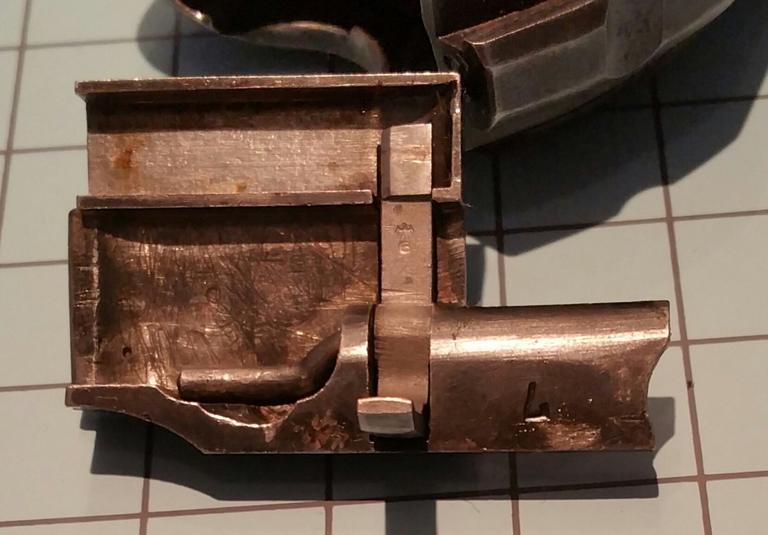

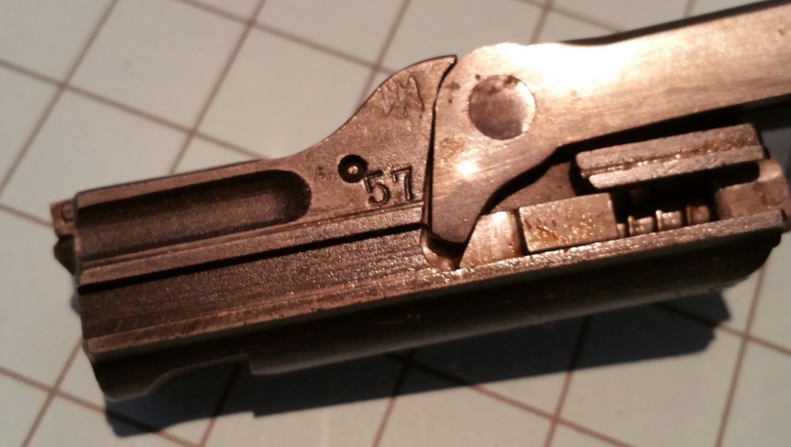

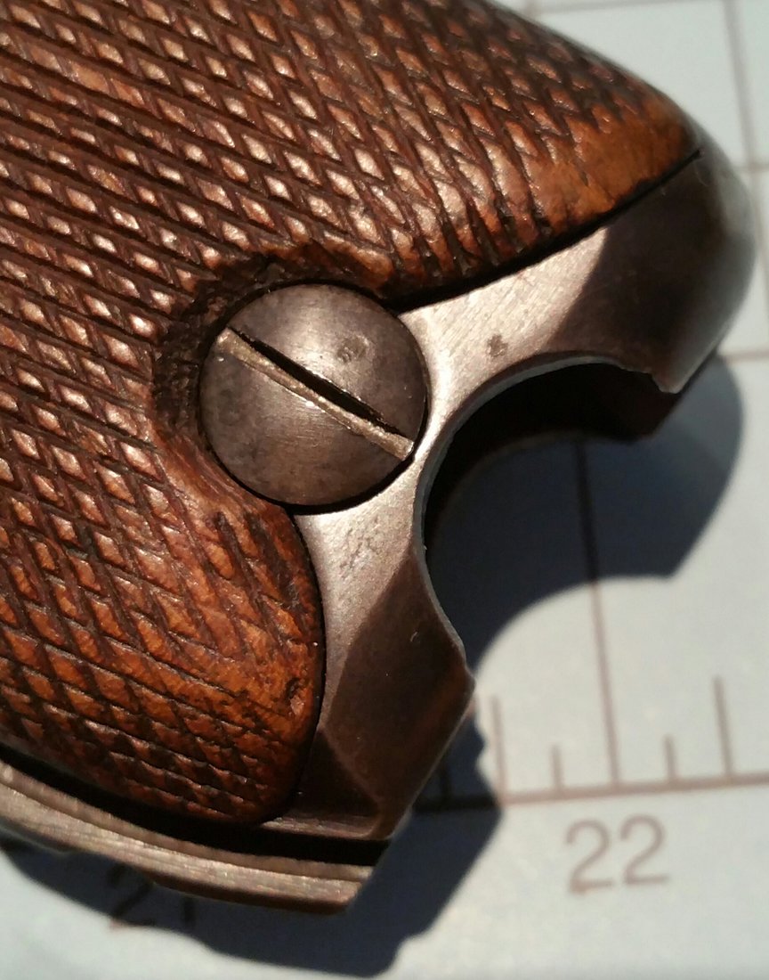

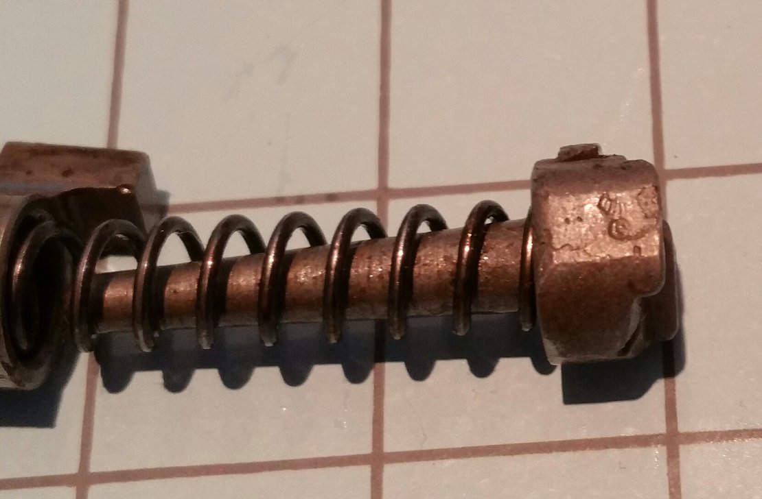

Thanks to all for the insight. Here are some more pics of the same pistol

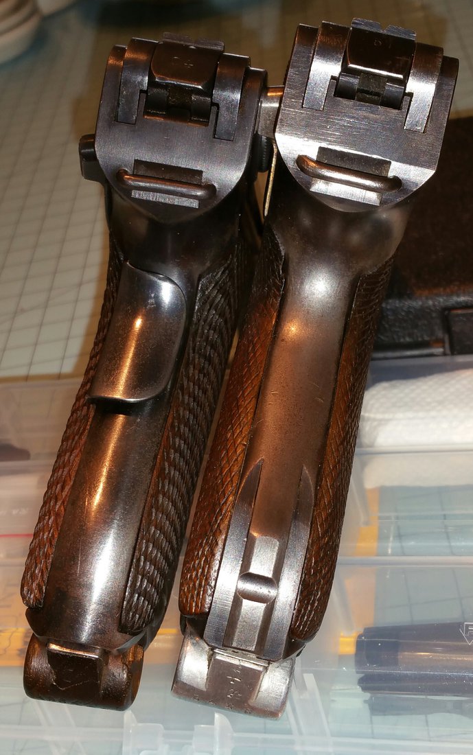

I just noticed the Simson on the right has a more squared off rear curve above the loop unlike the gently curved Vickers on the left. there is a line you can feel on the Simson frame.
The Vickers loop is more square than the Simson
